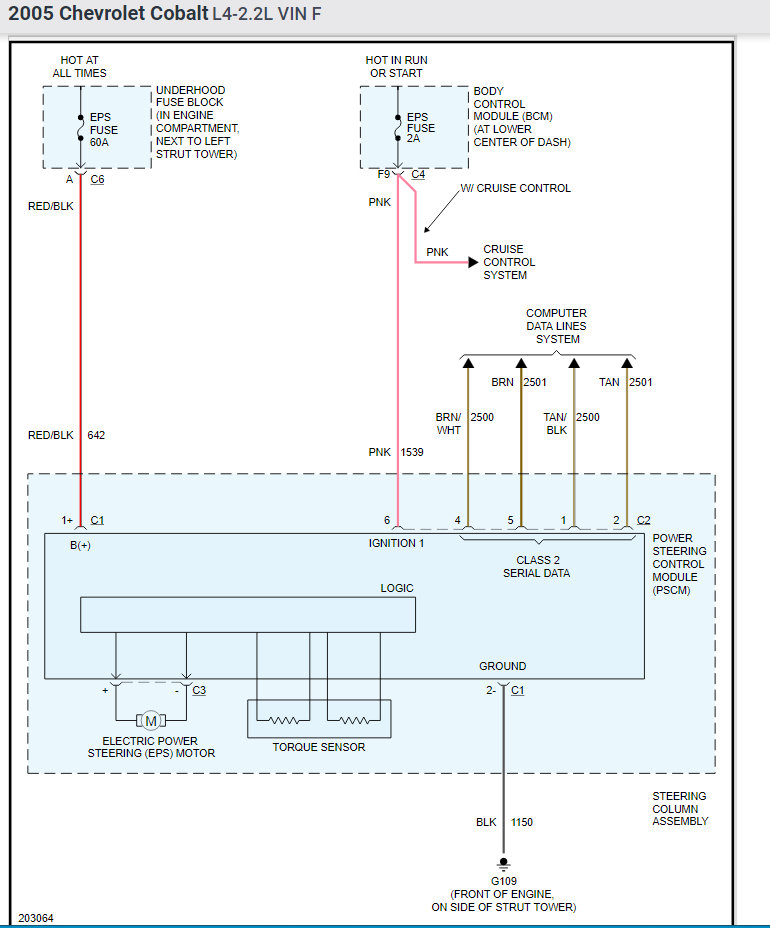

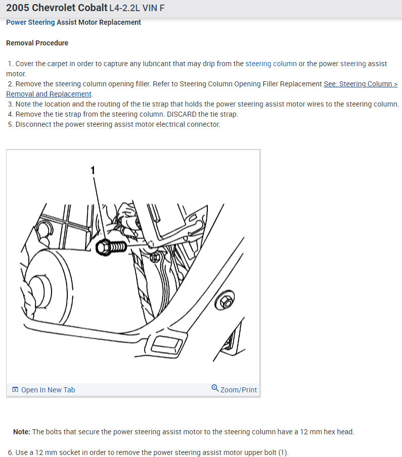

no communication with steering module .have no power assist?
Aug 25, 2009 at 9:18 AM
SQM
  • 6,383 POSTS

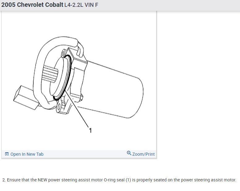

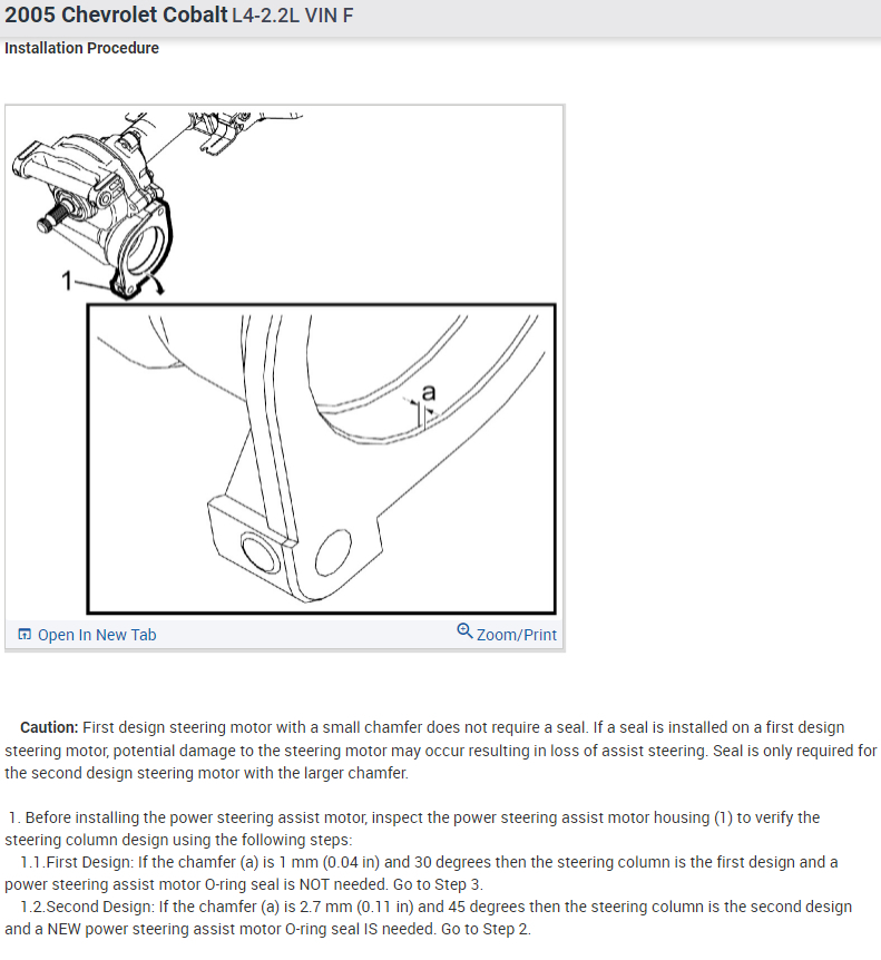

You might have a blown fuse for the power steering pump, that could be reason it is not functional.
The fuse is located under the hood fuse block next to the left strut tower. It is a 60A fuse. Check the fuse to see if it is blown. Replace as necessary.
If the fuse is good then you need to make sure you are getting power to the power steering motor. If you are getting power to the motor connector then the motor is faulty.
