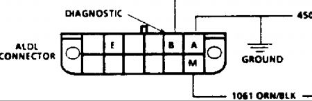

First step do not disconnect the battery after it dies, lets read the codes first. here's how:
Cross these two terminals as shown, then turn the key on. Count the flashes, a 22 will flash as 2 flashes then a short pause, then 2 flashes, if more than one code is stored, the pause will be longer. The codes will display three times and end with 12. Write them down and post here. This connector is right under the middle of the dash...
https://www.2carpros.com/forum/automotive_pictures/62217_ALDL_5.jpg
Connect A and B with a paper clip or jumper wire turn key on read codes. Post all stored codes!

I did code and it showed a 12 every time

Use that volt meter on the orange and black wire on the aldl test connector, is 12 volts present?
