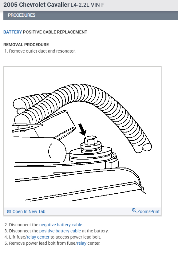

My problem is that I can't get it to start, I changed the starter cause it sounded like the starter was stuck, changed the battery with a new one, tried to jump start it, tried heaters under the oil pan to warm up the oil, still nothing. I don't know what or where to look for anymore, do you have any suggestions?

Try removing the drive belt. you might have a seized alternator, pulley or ac compressor or the starter is bad here is a guide to help you fix the problem

I replaced the positive battery cable that was the problem FYI.

Thank you for sharing the fix for the issue that you had.
When the battery is unable to put out enough power to the starter it will not start. And where there is corrosion on the battery cable or terminal it could be difficult to start even when trying to jump the vehicle.
Here is a guide on how to clean battery cable:

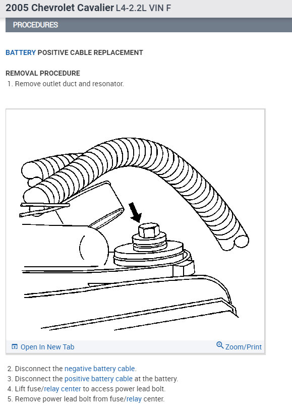

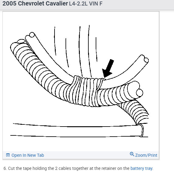

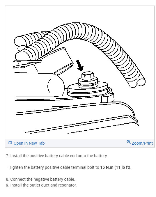

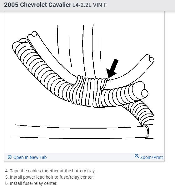

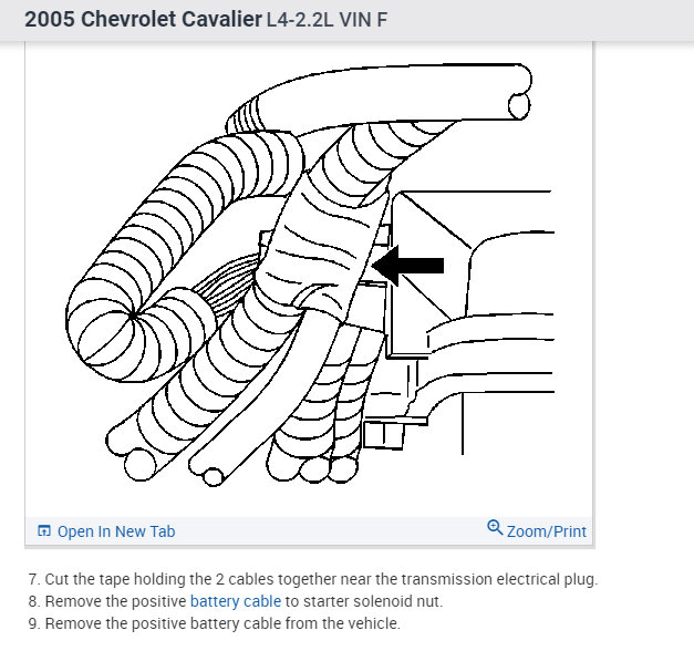

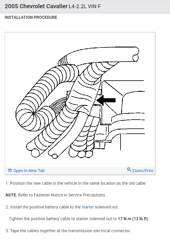

I have attached the battery cable replacement procedure below for anyone who might be looking for that information.
