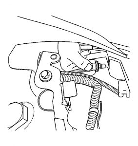

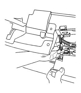

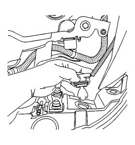

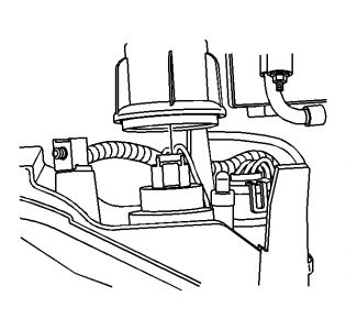

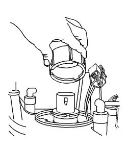

I have a 2004 chevy cav and im wondering how do I change the head lights.
its a lot different than my old cars and I cant figure it out.

1. Open the hood.
2. Remove the hood close out filler panel.
3. Remove the bolts from the headlamp assembly.
4. Position the headlamp assembly away from the vehicle to access the bulb electrical connectors.
https://www.2carpros.com/forum/automotive_pictures/55316_04cavalierheadlight_1.jpg
5. Remove the sidemarker lamp bulb/socket from the headlamp by rotating the bulb/socket
counterclockwise, if necessary.
https://www.2carpros.com/forum/automotive_pictures/55316_04cavalier77_1.jpg
6. Remove the turn signal lamp bulb/socket from the headlamp by rotating the bulb/socket
https://www.2carpros.com/forum/automotive_pictures/55316_04cavalier78_1.jpg
7. Disconnect the electrical connector from the headlamp, if necessary.
https://www.2carpros.com/forum/automotive_pictures/55316_04cavalier79_1.jpg
8. Remove the headlamp assembly from the vehicle, if necessary.
9. Remove the bulb access cover from behind the headlamp bulb, if necessary.
https://www.2carpros.com/forum/automotive_pictures/55316_04cavalier80_1.jpg
10. Disconnect the electrical connector from the headlamp bulb/socket, if necessary.
https://www.2carpros.com/forum/automotive_pictures/55316_04cavalier81_1.jpg
11. Remove the headlamp bulb/socket retainer ring from the headlamp by turning the ring
https://www.2carpros.com/forum/automotive_pictures/55316_04cavalier82_1.jpg
12. Remove the headlamp bulb/socket from the headlamp assembly by pulling the socket straight
out, if necessary.
https://www.2carpros.com/forum/automotive_pictures/55316_04cavalier83_1.jpg
Install is reverse.
