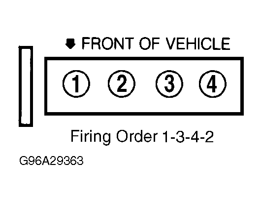

Need a wiring diagram for firing order for this car?
Sunday, May 17th, 2009 AT 9:51 AM
16 Replies
JDL
  • 16,098 POSTS
https://www.2carpros.com/forum/automotive_pictures/170934_chevy_cavalier_3.jpg
My info showed this for the 2.2 Litre engine.

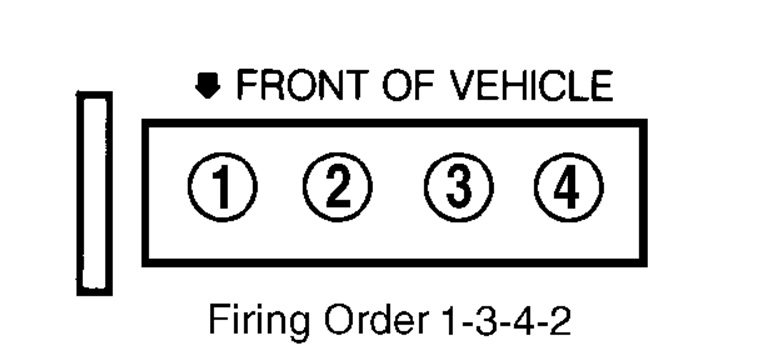

What is the firing order for a 1997 Chevy Cavalier?
+1
Friday, February 5th, 2021 AT 9:34 AM (Merged)
JDL
  • 16,098 POSTS
Here you go, hope it helps.

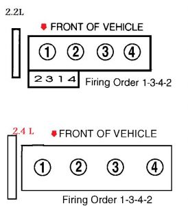

EOFRYE21
  • 1996 CHEVROLET CAVALIER
1996 Chevy Cavalier 4 cyl Automatic 160000 miles
My 1996 chevy cavalier will stop after i've driven it about an hour or two. Then i'll spray starter fluid into the air intake and it will start up and drive again. If I don't spray the starter fluid it will turn on then cut offf immediatley or just not at all. And my firing order is messed up after doing a tune-up. So how do I know which wires go where after i've messed them up already?
RHALL77
  • 3,361 POSTS
The coils should be marked what cylinder they go to.
The spark plugs go in order from the front of the engine
1, 2, 3, 4
4 is at the back of the engine

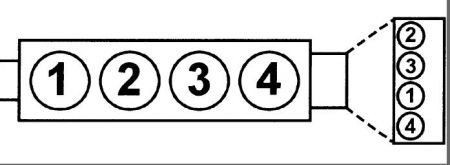

KYLEHEINZ
  • 1993 CHEVROLET CAVALIER
  • 4 CYL
  • FWD
  • 152,000 MILES
I had replaced the spark plugs and wires but I must have put them back on wrong my book says the firing order is 1-3-4-2 is this correct and do I count from left to right being spark plug number 1 being 1 and number 2 being 2 and so on and how are the distributer posts numbered meaning the post closest to the top of engine being number1 and the last post being 4 or do the numbers alternate?
Friday, February 5th, 2021 AT 9:35 AM (Merged)
TOOOMANYTOYS
  • 513 POSTS
This vehicle is equipped with coil packs on the back of the motor. One coil controls 1 and 4 and the other controls 2 and 3. The coils should be labled. Then just match them up one is for number one cylinder. Closest to crank pulley then work back from there.

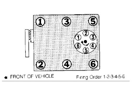

ANGELAIMIE
  • 1992 CHEVROLET CAVALIER
  • 6 CYL
  • FWD
  • 146,000 MILES
We had a tune up done the other day and since then my car has driven funny. It stalls and is running rough. I was told to check and make sure the wires were in the right firing order but I cant find out what the order should be. Can I please get the firing order so I can check it? Its 3.1L. Thanks this helps alot.
BLUELIGHTNIN6
  • 16,542 POSTS
That depends on the engine size..?
the 3.1L & 3.4L engine's firing order is below..
https://www.2carpros.com/forum/automotive_pictures/261618_Graphic_445.jpg

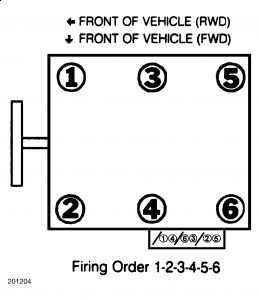

DUTCHEZ
  • 1988 CHEVROLET CAVALIER
Can you tell me the sparkplug firing order an the fuel injection firing order?
BMRFIXIT
  • 19,053 POSTS
Need to know what V6 you have and #8 VIN
this is one of them let me now if need more
https://www.2carpros.com/forum/automotive_pictures/99387_cav_1.jpg
