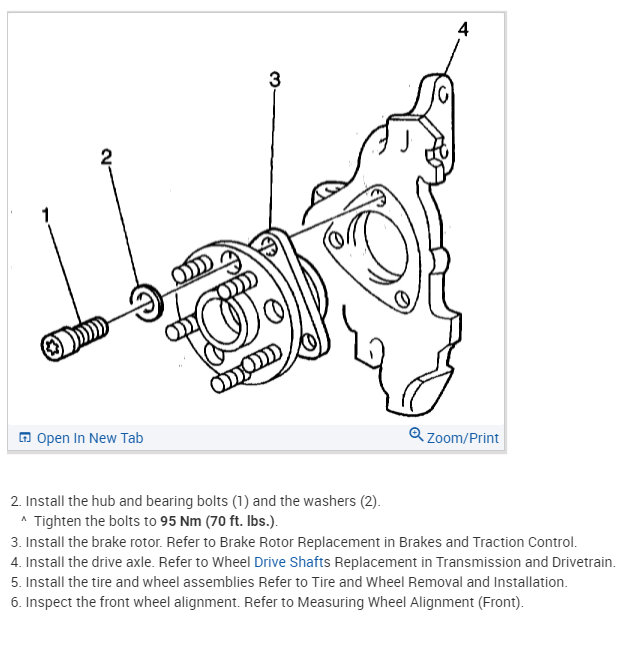

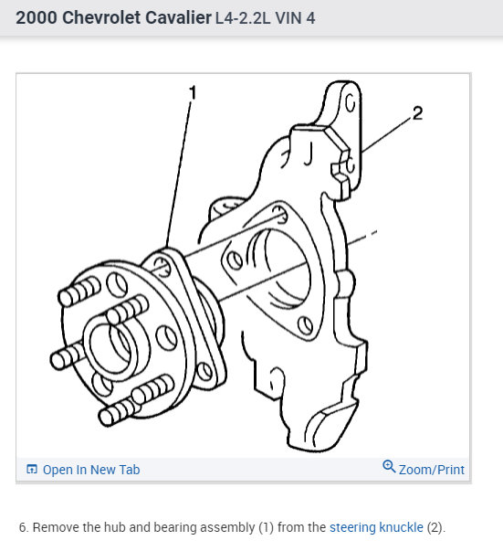

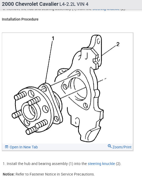

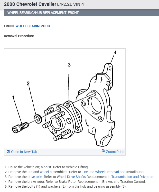

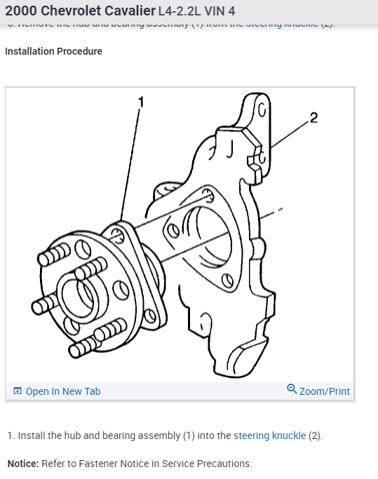

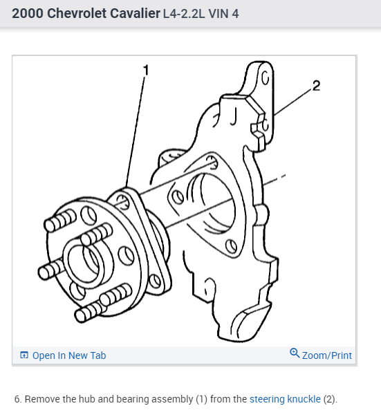

Try this, jack up the front wheels and secure it with jack stands.
Then turn the wheel by hand. If you can head the noise, then it is a bad bearing and needs to be replaced.
https://www.2carpros.com/articles/bearing-hub-replacement
