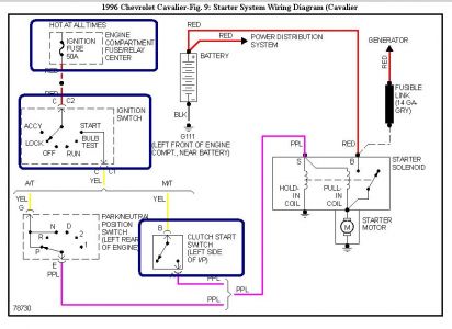

Ok. A little while ago my car wouldn't start. I thought the way it was acting that it was my starter. I could turn the key and the lights would come on, but when I tried to turn it over I get nothing, no sounds or even a hint of it wanting to start. Though i could short the terminals on the siloniod (sorry for spelling) and have it start with no problems. So i thought I'd just change the starter and it still did the same thing. I was instructed to replace the starter relay on the car, but I'm having trouble finding this relay. If there is such a thing, can some one please give me a hint to find it. Or if there is anything else I should check on.
Just to give more info:
I have a 96 Chevy Cavalier with a 2.2 engine

https://images.2carpros.com/forum/automotive_pictures/55316_96cavstarter_1.jpg
Your starter solenoid acts as the relay in this vehicle. I would concentrate my effort into the blue boxed parts; namely the ignition fuse inside the fuse box under the hood, the ignition switch (not where the key goes in, that is

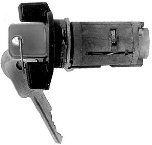

https://images.2carpros.com/forum/automotive_pictures/55316_lc14301_1.jpg
but this. This is connected to the key switch.

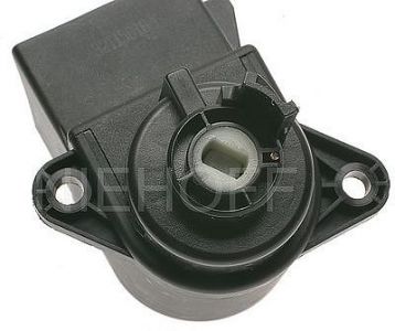

https://images.2carpros.com/forum/automotive_pictures/55316_ig204516_1.jpg
If that is working, then it will be your neutral safety/clutch switch
