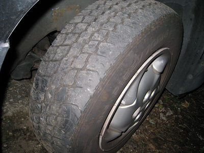

I drove about 850 miles this weekend, and above 65 the car would vibrate a lot, with the steering wheel shaking.
After the drive up (400 miles), I took it to Walmart to have the wheels balanced. When I came back, they said the order had been cancelled with "unsafe environment". They later explained that it was because the tires were "cupping", which indicates a problem with the suspension, so they didn't do the balance.
Since then, it seems to be vibrating even worse. I can feel it at 35 MPH.
The front right tire is worn in one spot, which is obviously because of some kind of balance or suspension problem, but I don't think it matches the descriptions of "cupping" I see online. It's only worn on one "side". I don't mean it's worn on one edge and not in the middle. I mean the pattern of wear is only visible with the tire rotated in a certain position. In other positions the tread looks pretty normal all the way across.
Does this seem more like an unbalanced tire/wheel, alignment, or failing suspension problem?
[img:5641d56cf8]http://www.2carpros.com/forum/automotive_pictures/269800_00030resized_1.jpg[/img:5641d56cf8]

Hi there,
Thank you for the donation,
You have an alignment problem, you will need to get the tyre replaced and have an alignment check done, this should also include a full suspension & steering component inspection as if anything is worn an alignment is a waste of time until the problem is rectified.

Alright. Wal-Mart told me it was a suspension problem, but I'm not sure I believe that. If I bounce the car it seems to settle quickly, and I don't think that would cause one tire to wear on one side.
Here are some hi-res pictures:

Hi there,
The suspension is a lot more than the the re bound rate, the wear in your pic is constant with a Camber adjustment problem, this is the amount of deg that the wheel lays out, this is set in deg, min & sec so a worn lower suspension arm bush, faulty ball joint, even a worn tie rod end or steering rack giving to much toe out can cause this, an alignment check will pick up the problem, but first a thorougher inspection of the steering & suspension must be done.
