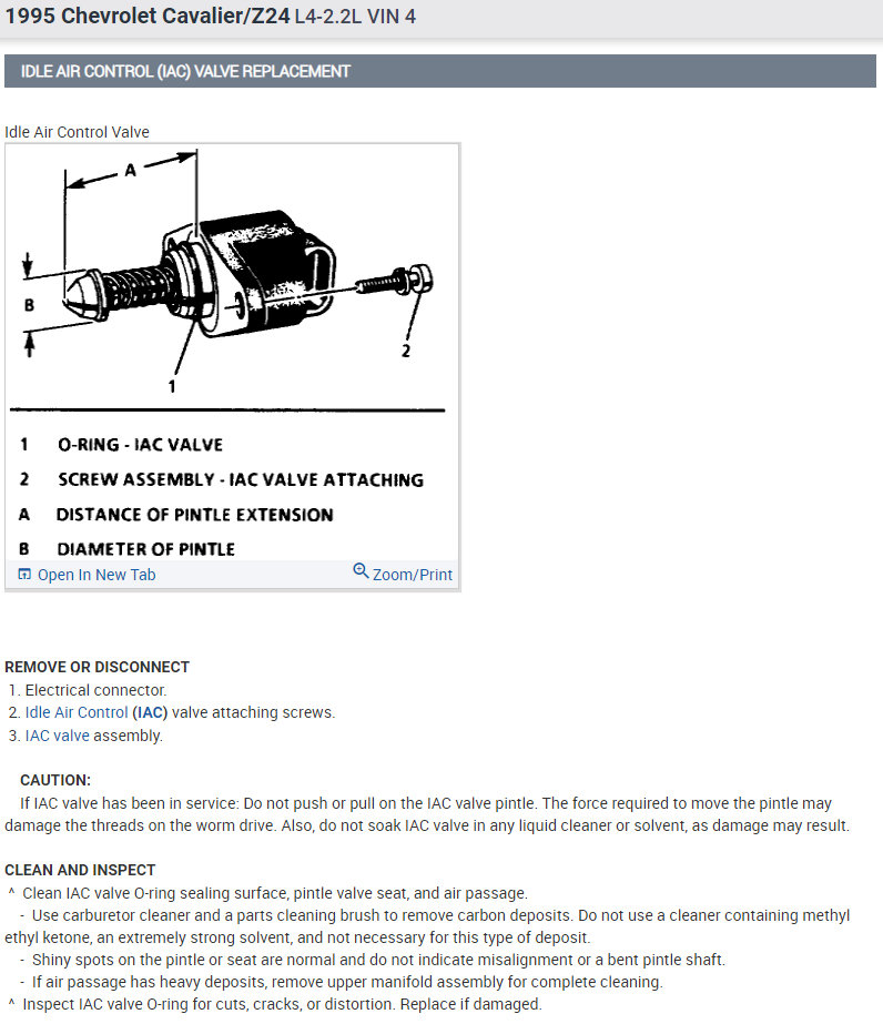

My car has been sitting for the past year what kind of maintenance should I do to it to get it back on the road?

Clean mass air flow sensor.

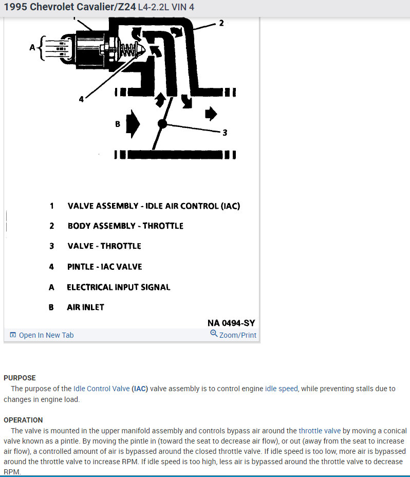

Clear idle air control vale.
Clean Throttle body.

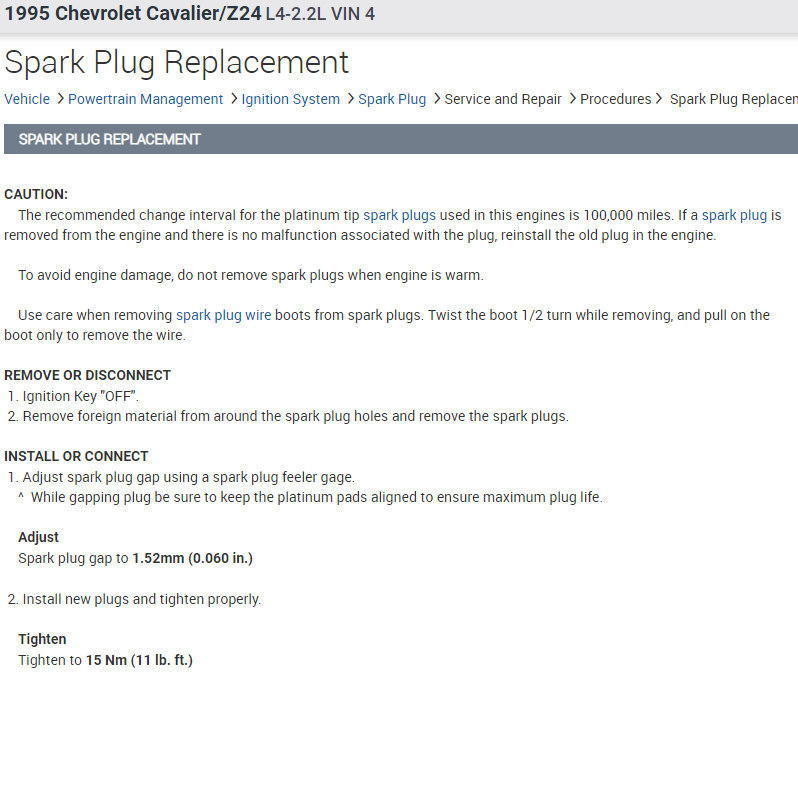

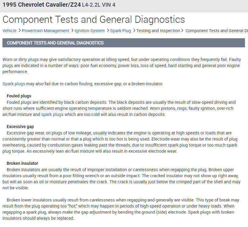

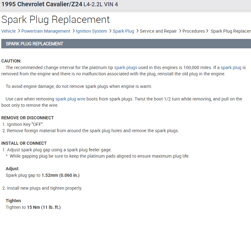

Change Spark Plugs.

https://www.2carpros.com/articles/idle-air-control-valve-service

I have attached the diagrams for your reference.
