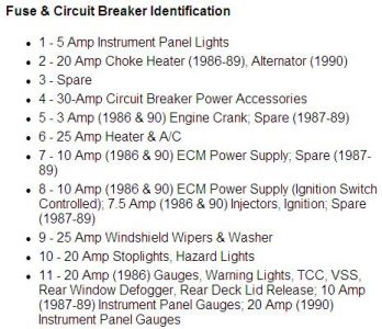

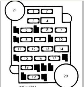

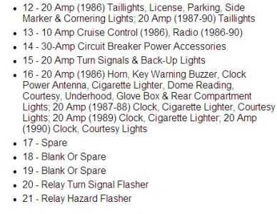

Hello. I need to know what fuse to change when the interior lights go out. The dash board light, the overhead light and radio are out. I stuck my car phone charger in the cigarette lighter holder and everything went out.

Welcome to the forum. I'd check fuse 16 and fuse 1.

Can you let me know the purpose for those fuses? Also what are the number fuses for the power locks, lighters and radio antenna?

I edited my previous post, should give you some info. Goodluck
