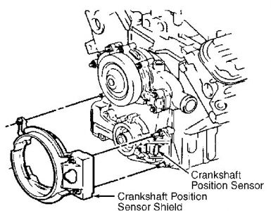

Hi my name is Monika, i have a Chevy Camaro 98 155,000 miles 3.8 Litre, I was just wondering if anyone could Pleaaase help me locate the Crank and Map sensors so i can replace them in detail ? and if its not too much i was thinking of putting power windows on this summer seing how its all manual so i was wondering if someone can tell me if that would wreck the car and what the right way to do it would be, i bought the Mitchelle repair book so if that helps maybe you can point out where on the book that would show me how .

Look in the engine performance section, ignition system. I don't have the book but logically that is where I would expect it to be.
https://images.2carpros.com/forum/automotive_pictures/30961_camcam_1.jpg
The right front wheel has to come off and the harmonic balancer as well to access the cranshaft position sensor. You'll need a puller for that.

Hi Thank you So much for your Help I really Appreciate it :D! could you tell me where the map Sensor is please ? :oops:

right rear of the intake manifold, above the valve cover.
