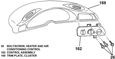

These instructions will disassemble the middle of your dash and gain better access to the center vents. Disconnect the negative battery cable. Remove the instrument cluster trim plate. Unfasten the heater and A/C control panel attaching screws/bolts and pull the assembly out far enough to reach the connections. Detach the blower switch electrical connector, vacuum harness connector and the temperature control cable. Remove the heater and A/C control panel from the vehicle.
https://images.2carpros.com/forum/automotive_pictures/261618_0900c152800b8737_1.jpg
This will allow access from bottom of vent. Should be able to detach vent and try fishing it out. Maybe better off having a mechanic do this though, as it may take more than just the a/c panel removal to gain access but this step is rather simple so if you can do this then it is worth the shot.
