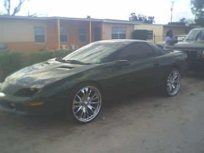

hi i have a 94 chevy camaro also and i was having that same problem and i took it to the shop and i was told i needed a new coil pack my car was misfiring and my belt tension pulley needed to be change. in after i did it i had no more problems. i also change my wires and spark plugs.
