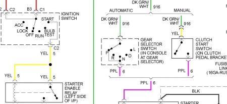

I have a 1989 camaro rs turn switch on get nothing.I checked battery it ok, starter, solenoid ok put in new safety neutral switch, ignition switch and checked all fuses
there ok.

Hi dbresler, Welcome to 2carpros and TY for the donation
Inspect and test all the fusible links and then report back -power has to go thru the links before it goes anywhere such as the ignition switch/headlights

Double check the ignition switch for power going into it-also check the main wiring harness, also battery and connections.

Once again-
If there's no power to the ignition switch I strongly suggest you triple check the fusible links if okay inspect the main wiring harness thoroughly-
https://www.2carpros.com/forum/automotive_pictures/12900_s1_66.jpg
https://www.2carpros.com/forum/automotive_pictures/12900_s2_58.jpg
