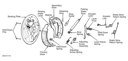

1996 chevy blazer 4.3 auto 4wd, 198,453km. I guess with this milage I'v got my fingers crossed! Took it to the dealer and they said it is the ABS brake module. The cost will be $2000.00 plus labour. HA HA! I went to the junk yard and bought one for $150. Installed it, blead it at the wheels (got no air ) and test drove it with no ploblems. Four weeks later it started abs pressure releasing on dry roads and the left rear wheel does intermitent lockup making everyone stare at you like you don't know how to drive.I don't believe that there is abs at the wheel sensors on this model and everything else is new, front pads, rear shoes, wheel cylinders, drums and front rotors. Do I live with this wondering if I or my wife and kids will stop every time or go by to the junk yard and try again. Thank sro

One of the things that can cause it is the secondary and primary shoes are reversed. The shoe with the longest lining is the secondary. Use new hardware and grease the tabs on the baking plate!
https://www.2carpros.com/forum/automotive_pictures/62217_Rear_Shoes_1.jpg
The other thing that will cause it is contaminated shoes! Oil , grease, or brake fluid on the linings!
