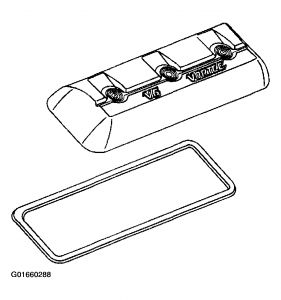

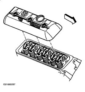

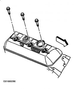

how do i remove the valve covers on this motor?
Jun 29, 2009 at 10:09 AM
BLUELIGHTNIN6
  • 16,542 POSTS
Remove the valve cover bolts Remove and discard the valve cover bolt grommets Remove the valve cover Remove and discard the valve cover gasket
