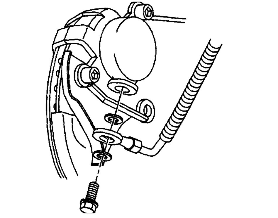

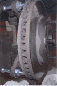

I have been trying to remove the front rotors from my 2002 2dr/2wd 4.3L Blazer (67,000 miles - first brake job). They seem to be hopelessly rusted onto the hub because they will not release even when struck repeatedly (and I mean that!) with a 2-pound hammer with serious effort. I got the rotor loose but hit my brake hose.

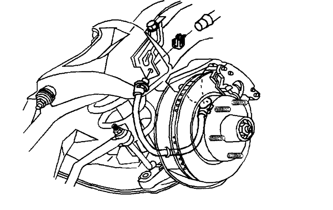

Brake Hose Replacement - Front (Single Piston Caliper)
Removal Procedure
1. Raise the vehicle. Refer to Vehicle Lifting.
2. Remove the front tires and wheels assembly.
3. Clean all dirt and foreign material from the brake hoses and the brake pipes.
4. Using a backup wrench on the brake pipe fitting, disconnect the brake pipe from the brake hose.
Important: Install a plug or cap in the brake pipe to the exposed brake pipe fitting end in order to prevent fluid loss and contamination.
5. Disconnect the brake pipe fitting from the flex brake hose at the frame.
6. Remove the front brake hose retainer at the frame bracket.

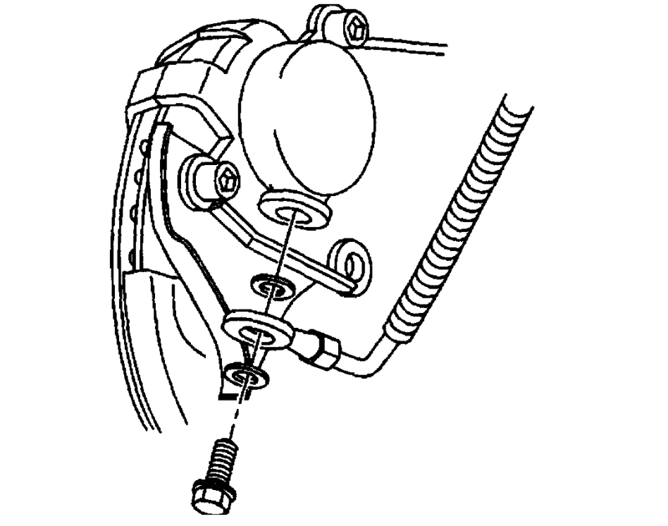

7. Remove the hose front flex brake hose bolt and gaskets from the brake caliper.
8. Remove the brake hose from the brake caliper.
9. Remove the copper gaskets from the brake hose bolt. These gaskets maybe stick to the brake caliper or the brake hose bolt.
Installation Procedure
Important: DO NOT reuse the old copper gaskets. Always use NEW copper gaskets.
1. Install the NEW copper gaskets on the brake hose bolt.
Notice: Refer to Fastener Notice in Service Precautions.
2. Install the brake caliper bolt to the brake caliper.
Tighten the brake hose bolt to 44 Nm (32 ft. lbs.).
3. Remove the plug or cap from the exposed brake pipe fitting.
4. Install the brake hose to the brake pipe.
Important: Ensure that the brake hose is not twisted and does not come in contact with any of the suspension components.
5. Using a backup wrench on the brake pipe fitting, tighten the brake hose fitting.
Tighten the brake hose fitting to 17 Nm (13 ft. lbs.).
6. Install the brake pipe retaining clips.
7. Bleed the hydraulic brake system.
8. Install the tire and wheel assembly.
9. Lower the vehicle. Refer to Vehicle Lifting.
