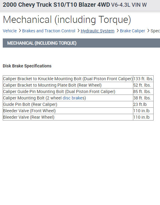

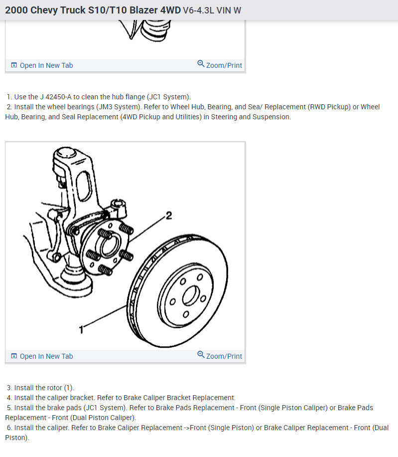

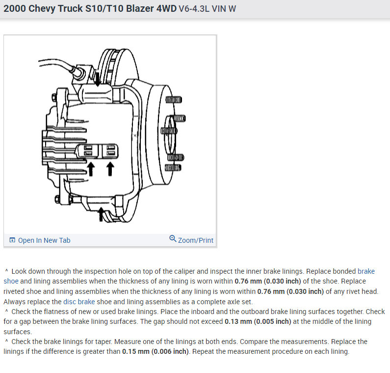

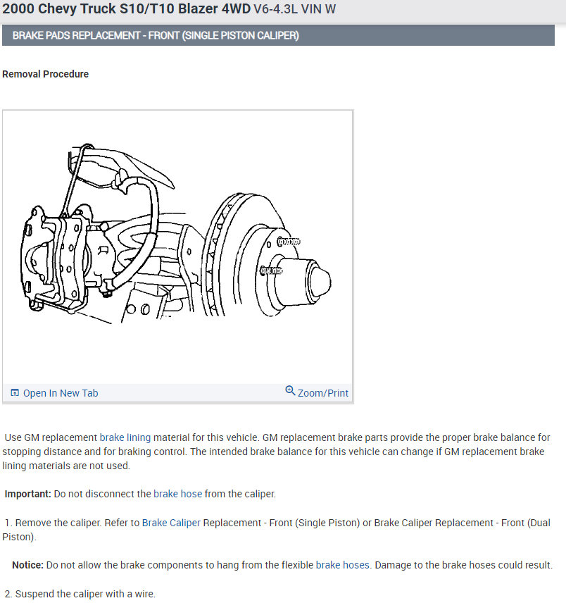

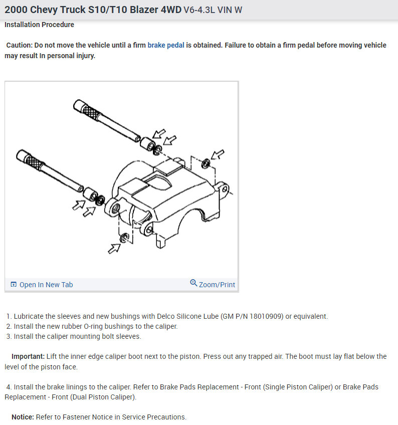

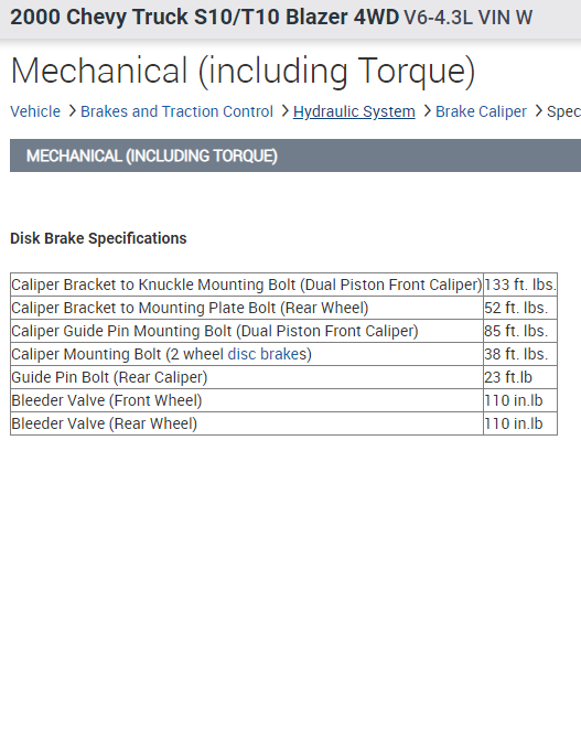

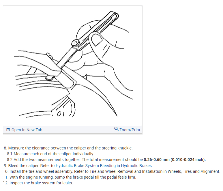

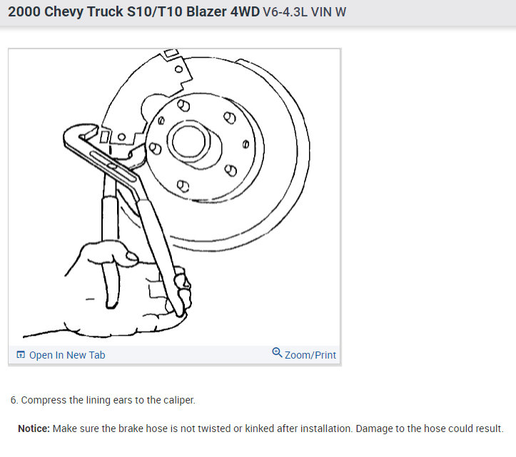

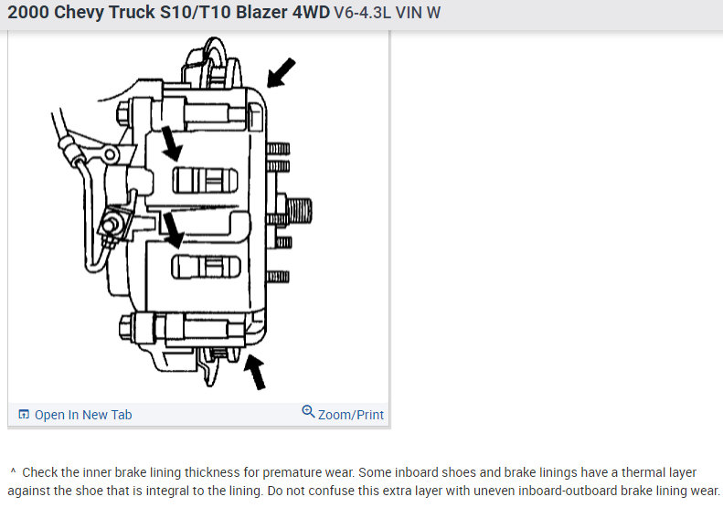

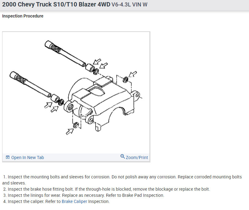

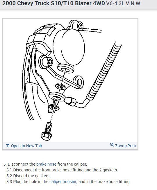

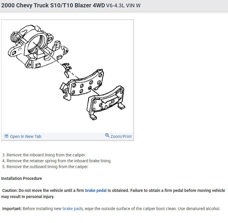

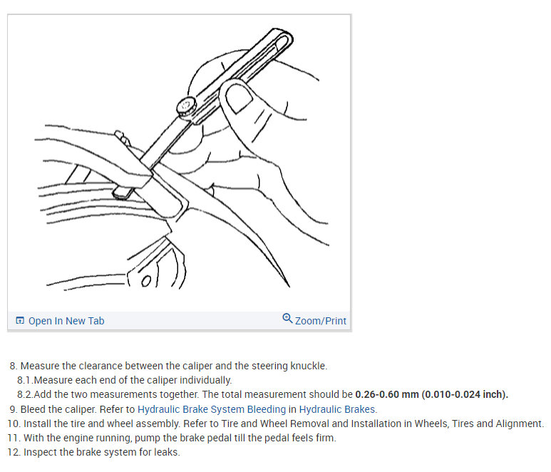

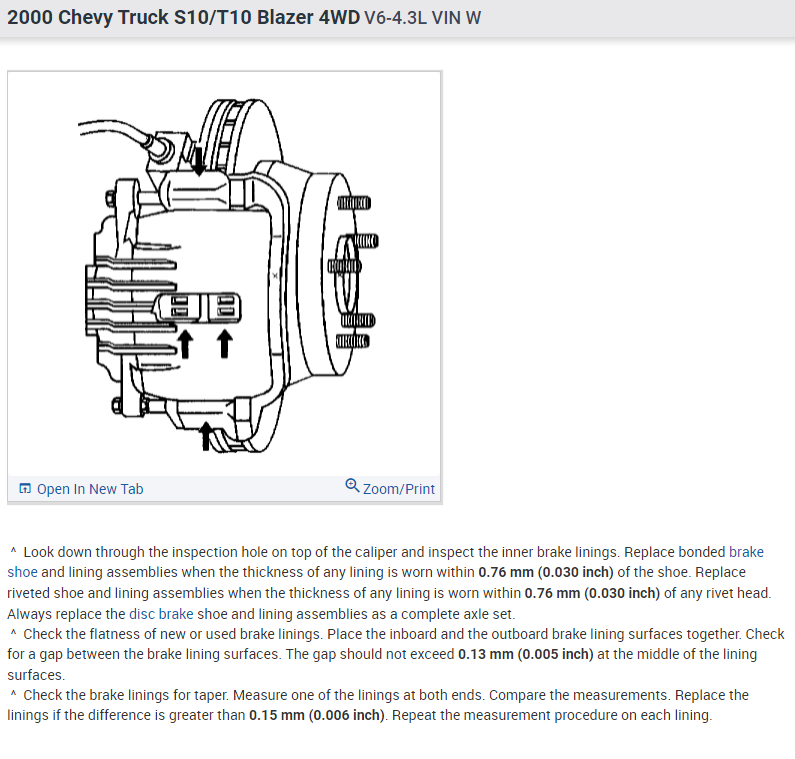

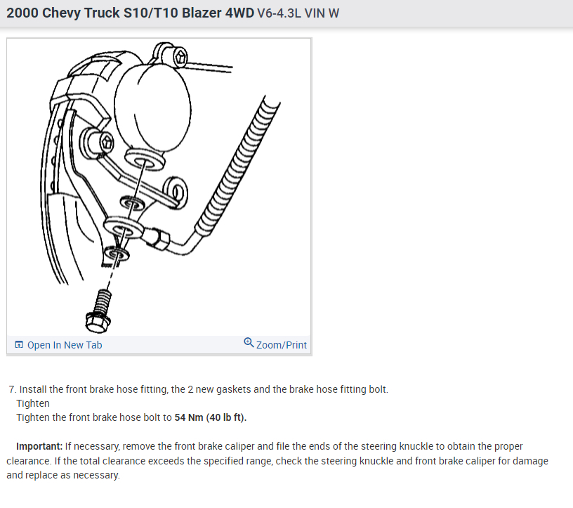

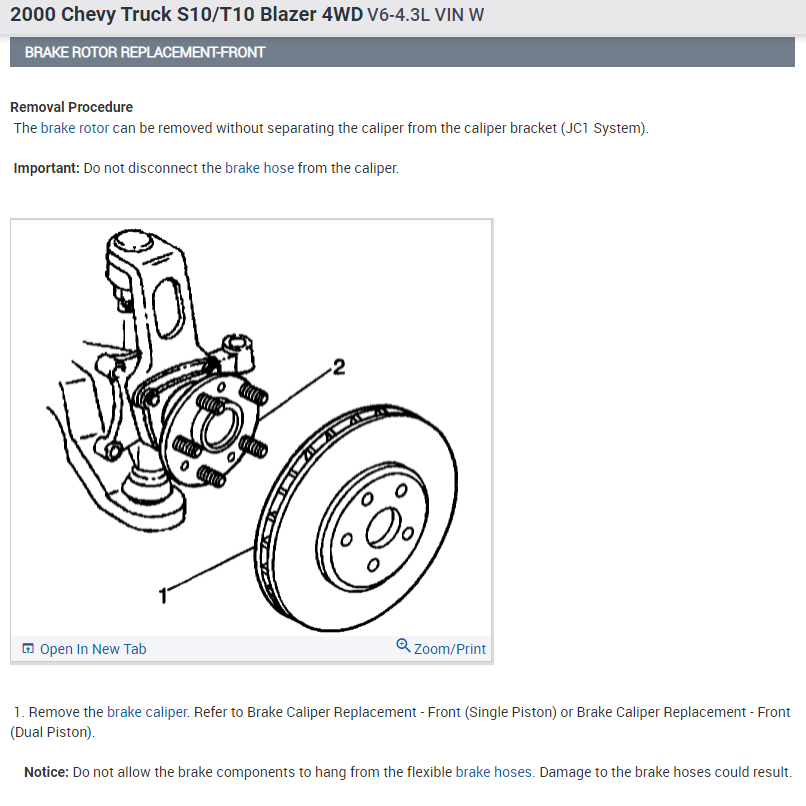

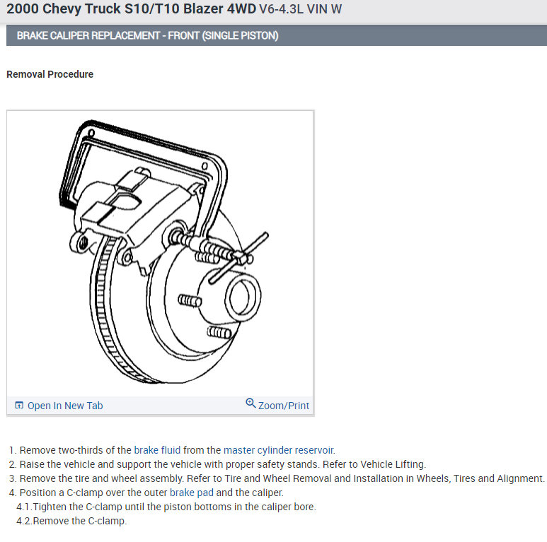

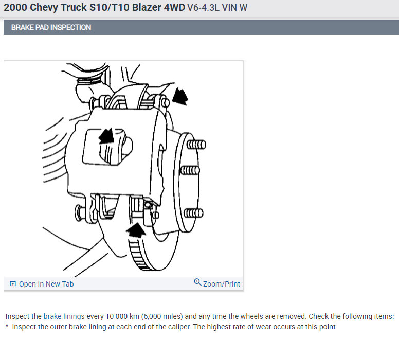

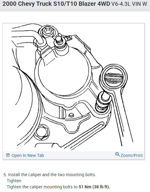

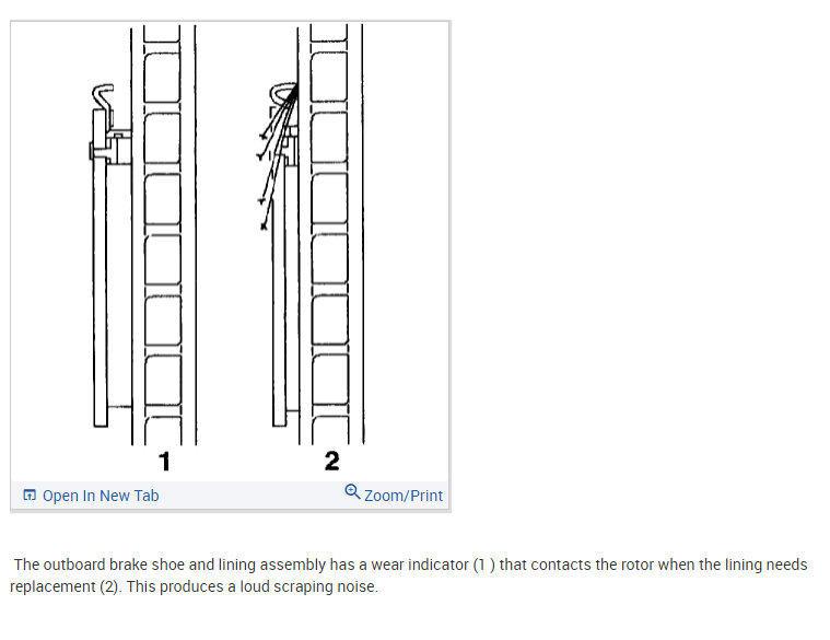

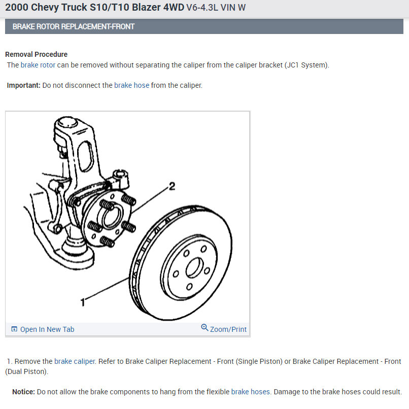

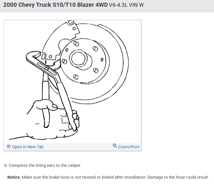

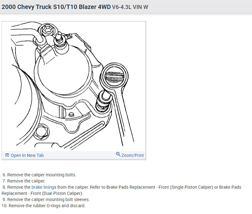

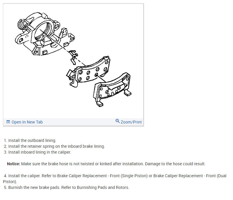

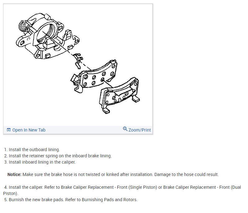

I have attached the brake inspection as well as complete replacement procedures for pads, rotors and calipers for your reference.
