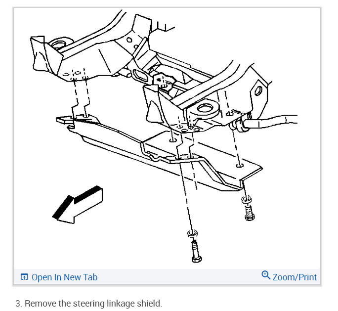

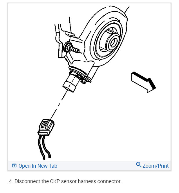

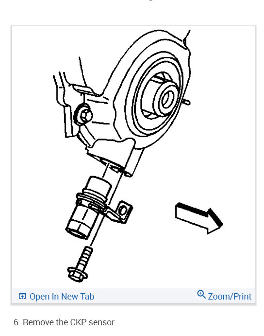

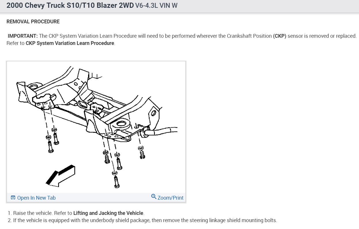

This sounds like it was the crankshaft sensor. Here is a guide to help you step by step and the location of the sensor for your car below.
This guide can help as well.
https://www.2carpros.com/articles/engine-stalls
Check out the diagrams (below). Please let us know what you find.
