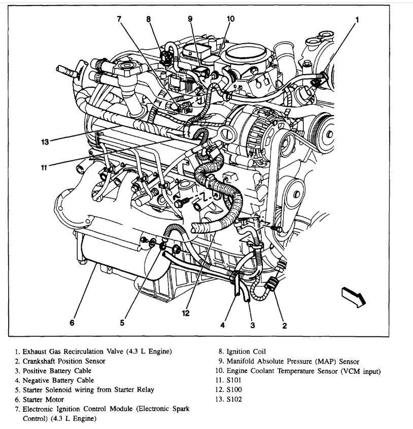

Hi Nancy, It does not sound like a transmission problem to me is sounds like the engine is misfiring, I would do a full tune up and throttle body service, spark plugs, cap rotor and spark plug wires. here is a guide to help you fix it.
https://www.2carpros.com/articles/how-to-tune-up-a-car-engine
Spark Plug Recommendations
AC Type .................... 41-932
