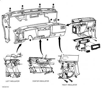

Whats the easyest way to remove and replace a heating core

There really is no easy way the dash needs removal.
Remove instrument bezel, hearter control bezel, knee bolster. Parking brake cable from dash. 4 bolts hold steering collumn . Ac controller and radio, speaker nd defrost grills all electrical connectors.And 9 dash bolts see diagram. Pull dash then unbolt core acess cover then core ,remove hoses.
