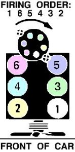

Check your firing order....
https://www.2carpros.com/forum/automotive_pictures/188069_92850034_1.jpg
https://www.2carpros.com/forum/automotive_pictures/188069_41894088_1.jpg
