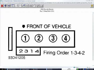

I need the ignition firing order to replace my sparkplug wires correctly

Same for 2.2 or 2.3..1, 3, 4, 2
