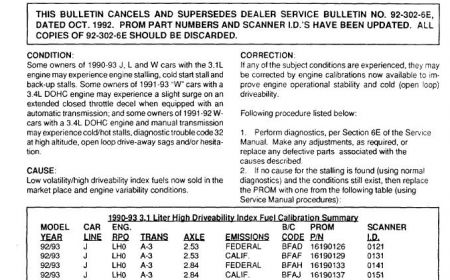

Hello, have you tried buying fuel elsewhere? I did see some bulletins about stall issues, caused by the type fuel used. The cure was calibrations/ new prom. They were dated 1993, I can't tell if that's the issue? Just a thought.

Actually I have I normally put chevron gas in all my vehicles I switched to diamond shamrock and added a octane boster and still same isuue. But what is the calibrations/ new prom im not familiar what that is. Thansks

https://www.2carpros.com/forum/automotive_pictures/170934_prom_1.jpg
That's part of the bulletin, not sure it is readable? That's from 1993, you may already have the up-dates, it has to do with the ecm. I can't tell if that's your problem or something else? I'm not positive if the up dates are still available?

That makes sence do you know where to get these updates and would it cost me to do so im thinking of taking it to the dealer I would imagine that they would have that scan tool? Thanks

You might call the dealership, ask for the service department, talk to them, sometimes they're very helpful. They can give you information on any updates and the costs.
The only reason I brought up the bulletin, it made me wonder about the fuel issue.
