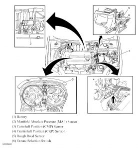

Code PO107, manifold absolute pressure/BARO S. where can I find it on the engine or manifold to replace it? What does this sensor do. Thanks, Dave

Hello, It is located on the fire wall side of engine about center way on plenum. For better view Press CTRL + to zoom in.
https://images.2carpros.com/forum/automotive_pictures/188069_06aveoMAP_1.jpg
