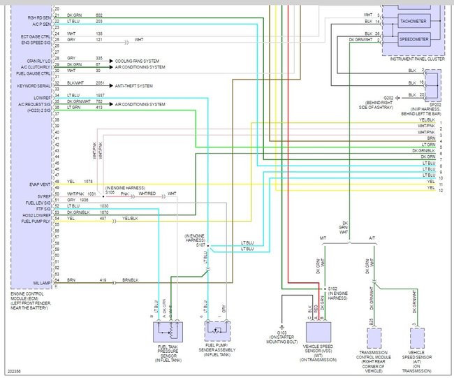

Does a Chevy Aveo has a reset button in the fuel system? Im having a problem with the fuel system. I checked the fuse and relay even I replaced the fuel pump but the pump is not working. I sprayed staring fluid in the intake and the car started for 2 seconds.

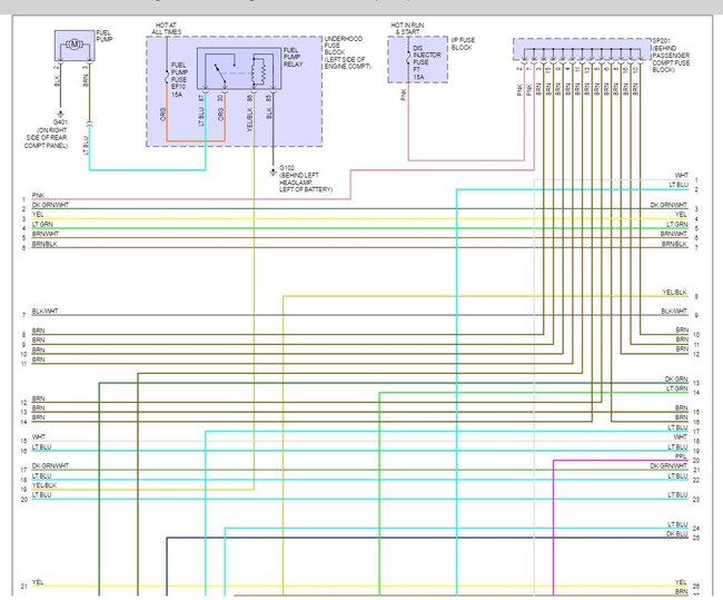

KEN L
  • MASTER CERTIFIED MECHANIC
  • 54,291 POSTS
Hello NICOLASHERNANDEZ
There is a couple of more fuses that need to be checked and a fuel pump replay in the under hood PDC here is a guide and some wiring diagrams to help you test and get the problem fixed.
and
Run some tests and get back to us so we can continue helping you.
Best, Ken

PD8946
  • 0 POST
Thanks for this post I had this problem and had to replace the fuel pump relay cost me $34.00 I love this site.

JDL
  • 16,098 POSTS
Welcome to the forum, I'd use a gage and check fuel pressure before suspecting the pump, Check for good voltage and ground at the pump, if that checks out and no pump action, suspect the pump. The pump is in the tank, You should be able to access by removing the rear seat. There is no reset button, that I'm aware of.
