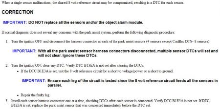

Computer dash board says: OIL CAHNGE SOON
and today PARK,SERVICE,ASSITS showed up..
what does that mean...??

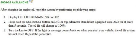

OIL CHANGE SOON Light is just a service reminder. After having oil changed, perform the following operations to reset the light.
https://images.2carpros.com/forum/automotive_pictures/261618_Noname_30.jpg

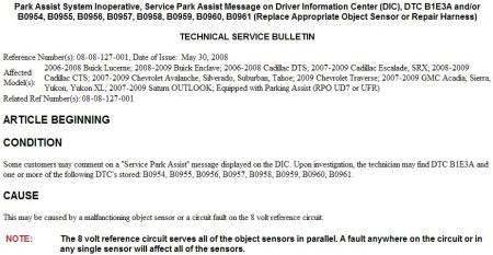

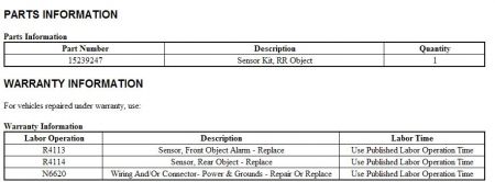

There is a TSB (Technical Service Bulletin) for the Service Park Assist warning light. If you still have warranty, check with your local dealer to see if this is under the warranty. Below is details of the TSB.
https://images.2carpros.com/forum/automotive_pictures/261618_Noname_31.jpg
