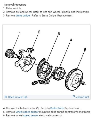

Probably needs a speed sensor which I believe is part of the hub on those. Need to have a scanner that can follow wheel speeds and determine which wheel is not following the the other ones when the problem happens.

I needs to repair my front left how do i do that. would i need help. or could i do it myself.

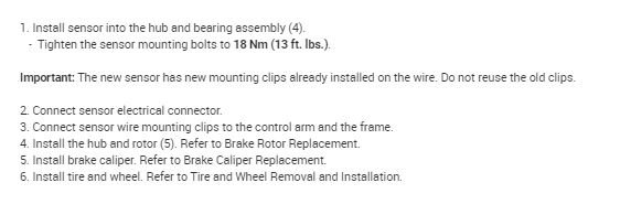

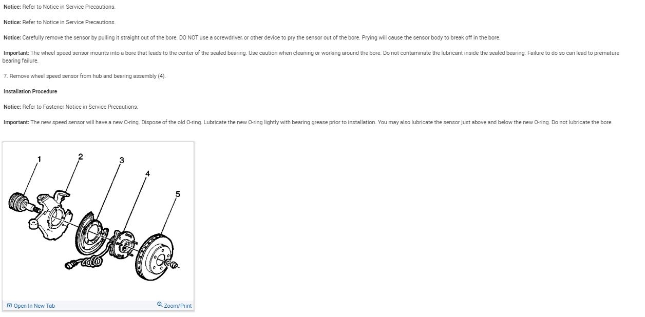

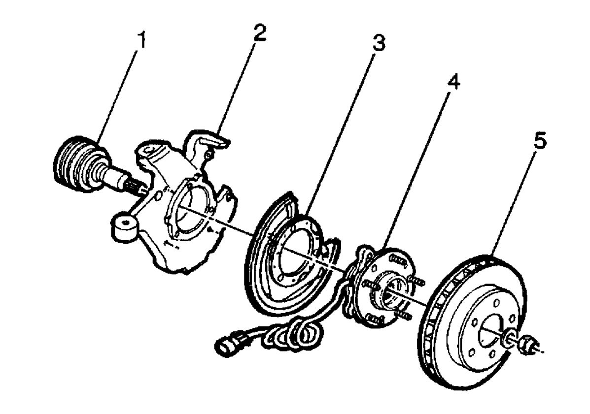

Its not too terribly difficult to do yourself
See the attached diagrams/instructions below for replacing the wheel sensor
