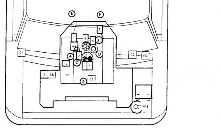

where is fuel pump reset switch located

There is no reset switch. There is a fuel pump test connector close to the relay. In the diagram C8. It's probably a gray wire with electrical connector, nothing plugged into it. If you use a jumper wire with inline fuse connected to battery voltage to the connector, the pump should run, for testing. You don't have to use the key.
https://images.2carpros.com/forum/automotive_pictures/512072_astro_test_connector_1.jpg
