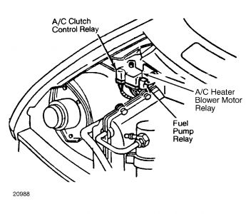

Hi Mary: The blower motor resister is where the power goes from the switch before it gets to the blower motor. It could cause the blower motor to not function. The resister is located on a bracket on the right (passanger) side. I tried to upload a picture of it for you. I hope it works. (first try)
https://images.2carpros.com/forum/automotive_pictures/249084_graphic_resister_1.jpg
of the engine compartment. Let me know if you get the picture and if it helps. Let me know if you don't get it and email me with you email and I'll send it as an attachment. (if you need it) Joe

Hi Again, Mary. Sorry, I sent you the picture of the relay. There is no picture of the resister. However, I can tell you it is located in the blower housing near the motor.
Sorry about the confusion. Computers drive me nuts.
