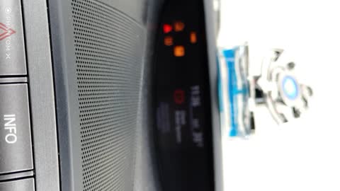

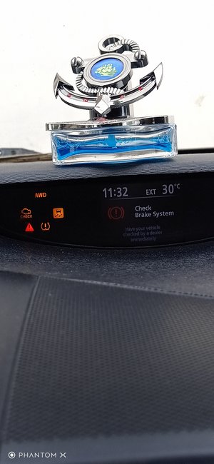

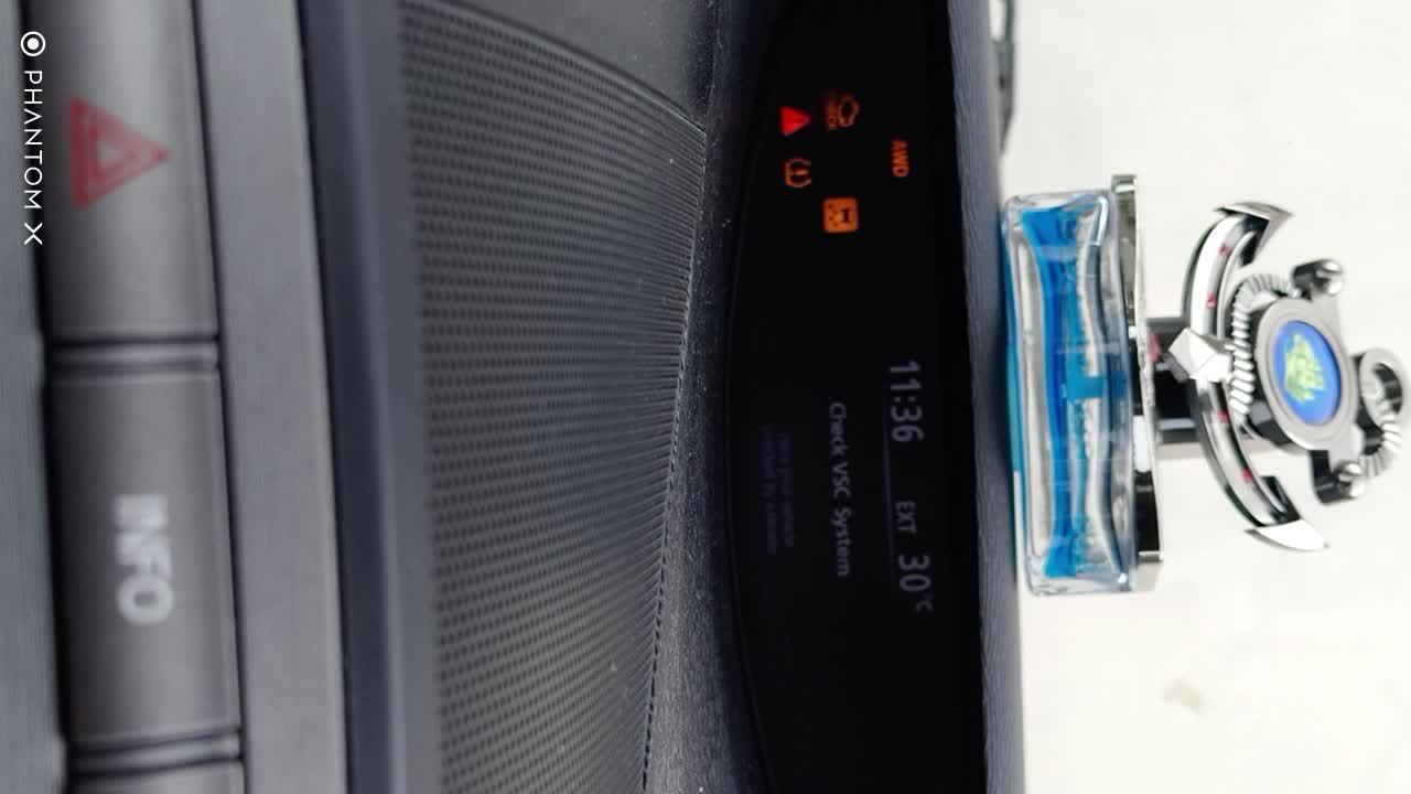

I recently changed the two front springs in my car after developing some faults and now I discovered some other faults.
The ABS, Check AWD and both tire signs are displaying on the dashboard.
What could be the reason for those?

This model isn't offered in the US, but I will try my best to help.
Based on what is happening, I suspect you either damaged, disconnected, or shorted one of the wheel speed sensors. That will set the codes you indicated.
Here is what I need you to do. We need to first locate the wheel speed sensors at the locations of the spring replacement and then inspect the connectors, wires, and for damage.
If nothing is found as a problem, then I need you to check for a signal from the wheel speed sensors. Here is a link that explains how this is done. You will need a voltmeter or multimeter to perform this test.
https://www.2carpros.com/articles/abs-wheel-speed-sensor-test
