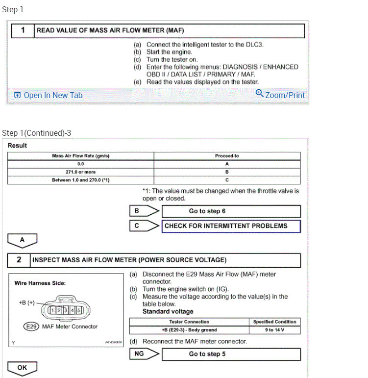

The light for check engine has been on despite checking, airflow sensor, cleaning the throttle and changing the plugs. When I start the engine, the vehicle can only move with the engine check on.
Other lights that are showing on the dashboard a triangle like light, skidding light, AFS light.

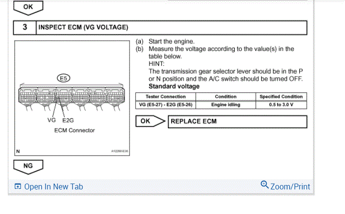

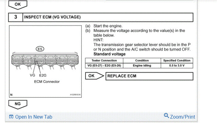

The scan was done, and it gave code p0102. The mechanic tried to change MAFS, but nothing has changed. The engine loses power sometimes.
Feb 17, 2022 at 9:39 AM
  • 110,248 POSTS

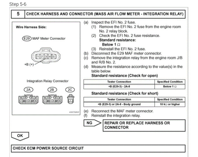

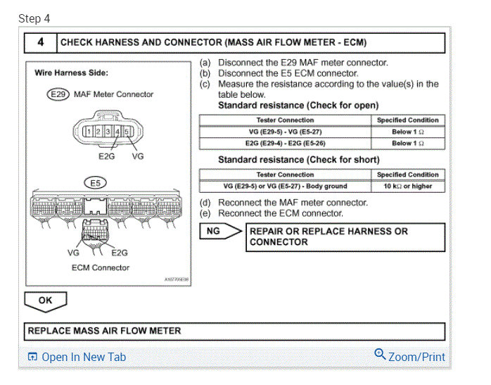

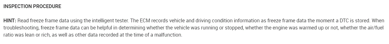

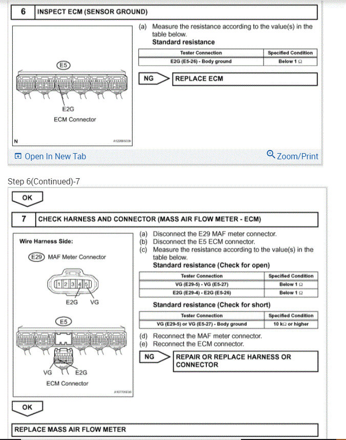

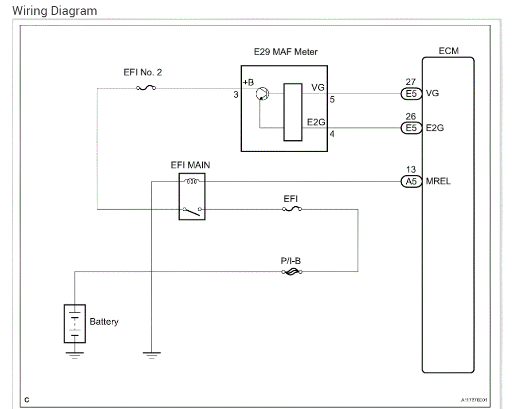

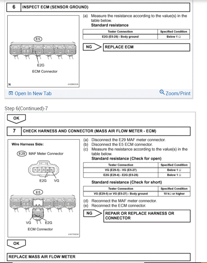

The code indicates low voltage to the MAF. Wiring and connectors need to be checked.
If you look below, I attached diagnostics. The sensor is likely not the cause, but rather a connection or damaged wire.
Take a look through the diagnostics and let me know if you feel comfortable performing them.
