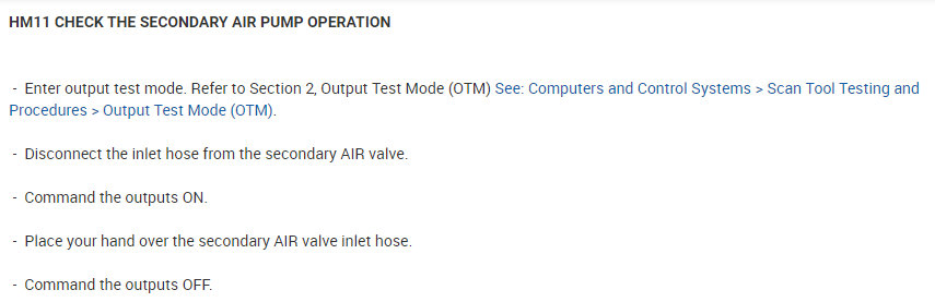

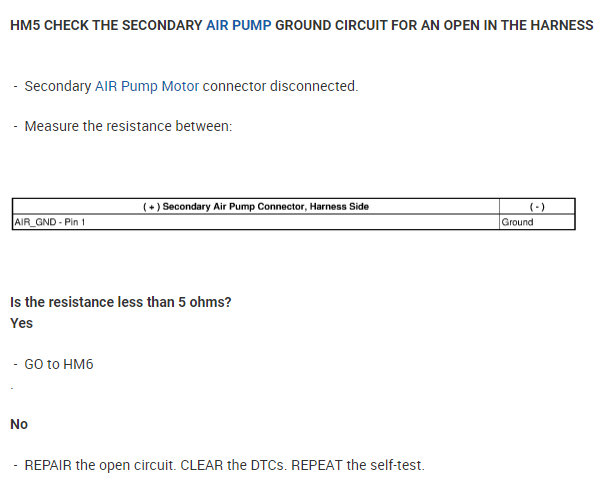

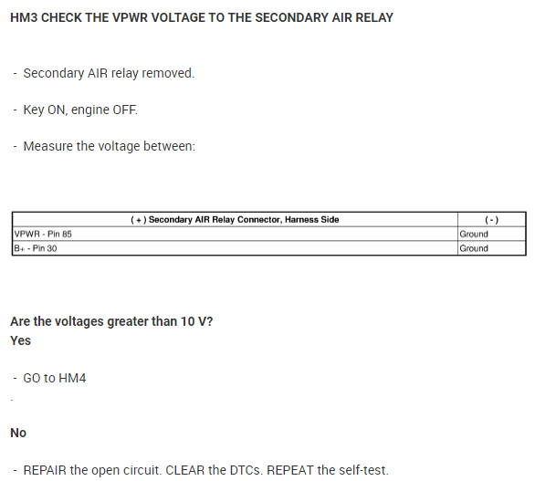

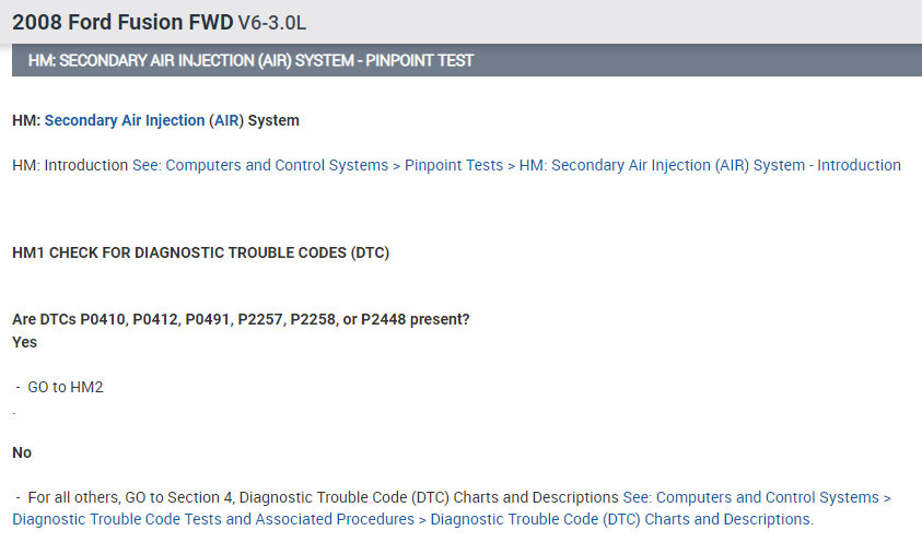

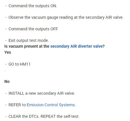

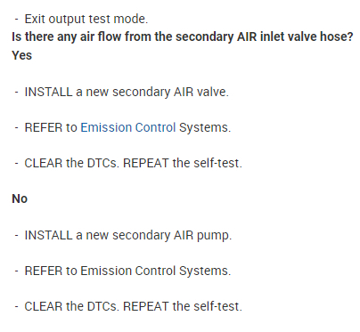

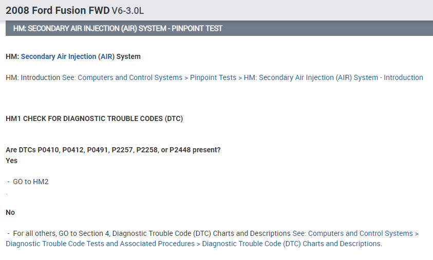

My wife drives the car and I am not around. The check engine light came on today and she took it to AutoZone to read the code. P2448 came up. Is the car safe to drive for a couple of days until she can get it to the shop for repair? She drives about eleven miles on the highway back and forth to commute to work.
Will it be expensive to fix?
Feb 27, 2018 at 8:51 AM
SATURNTECH9
  • 30,869 POSTS

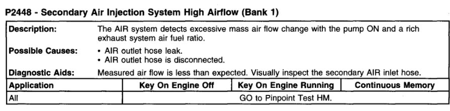

That is secondary air injection high air flow. she can drive it no problem for a few days. Without knowing the exact problem it is hard to say what it will cost to fix. To start with it will be a minimum of one hour shop labor rate plus the repair cost. It could just be a bad secondary air injection hose.
Feb 27, 2018 at 9:28 AM

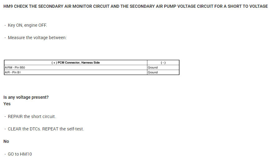

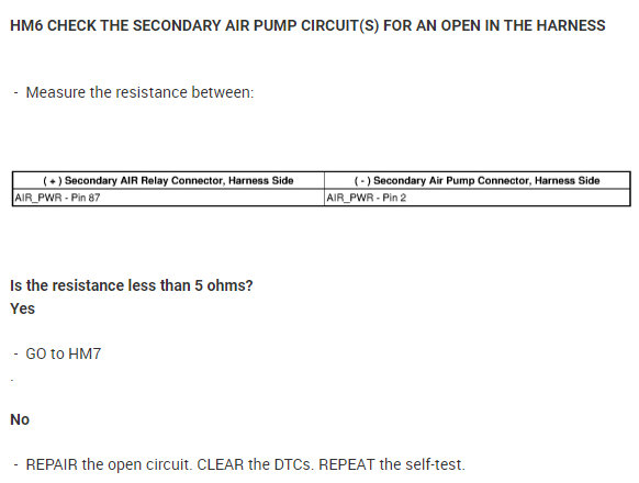

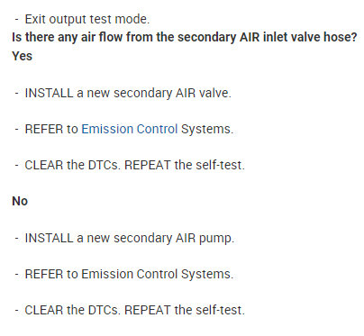

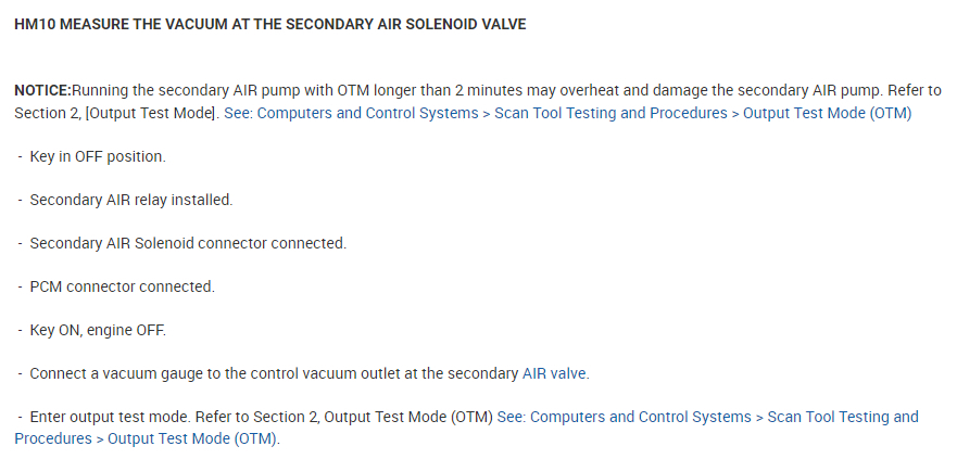

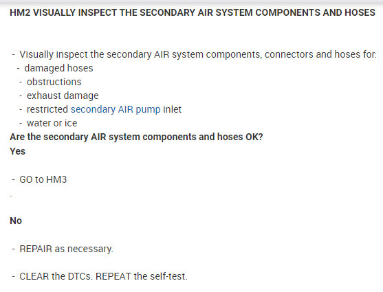

DANNY L
  • 5,648 POSTS
Hello, I'm Danny.

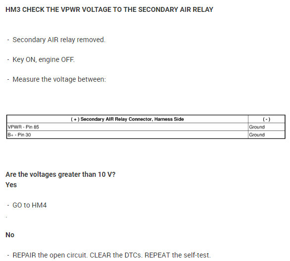

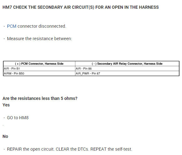

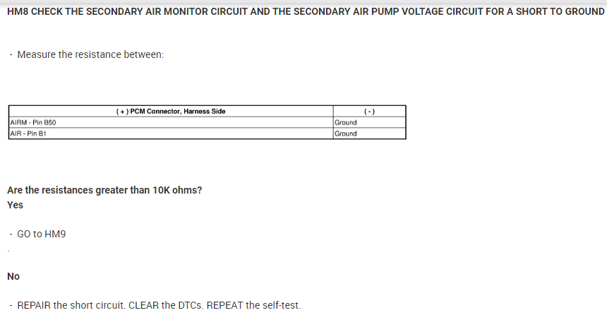

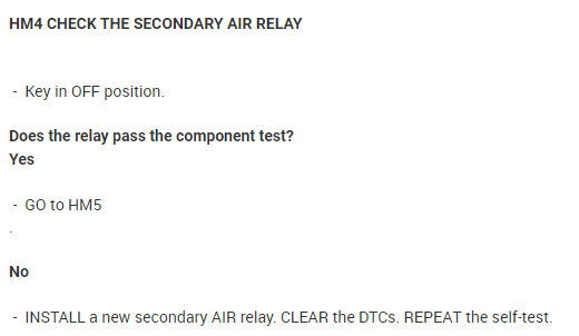

I've attached diagnostic steps below relating to code P2448 on your Ford. This should help in diagnosing the issue on your car. Hope this helps and thanks for using 2CarPros.
