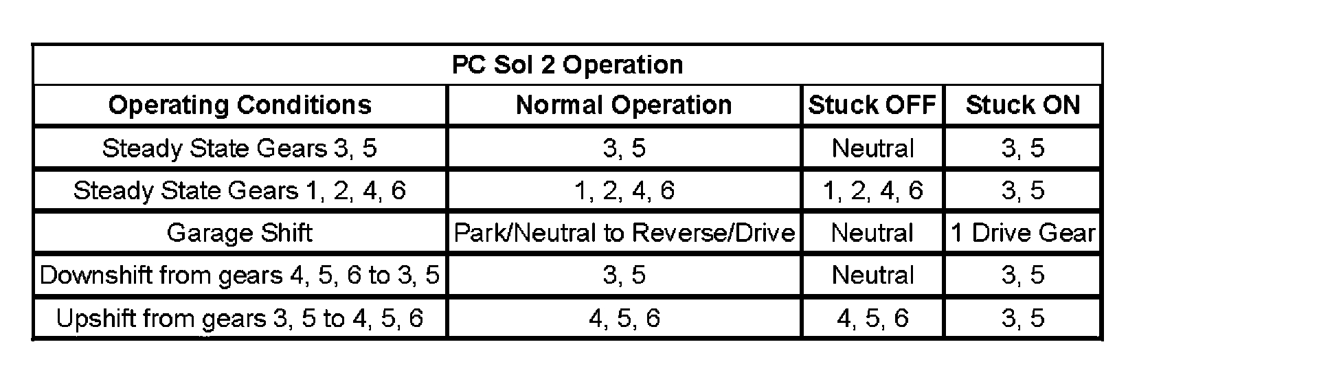

Component Testing
pic 1

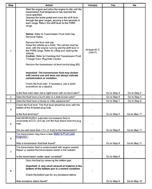

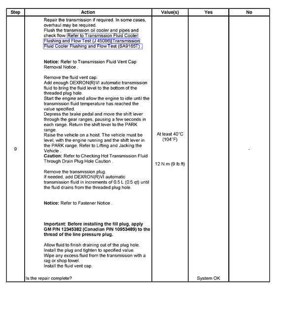

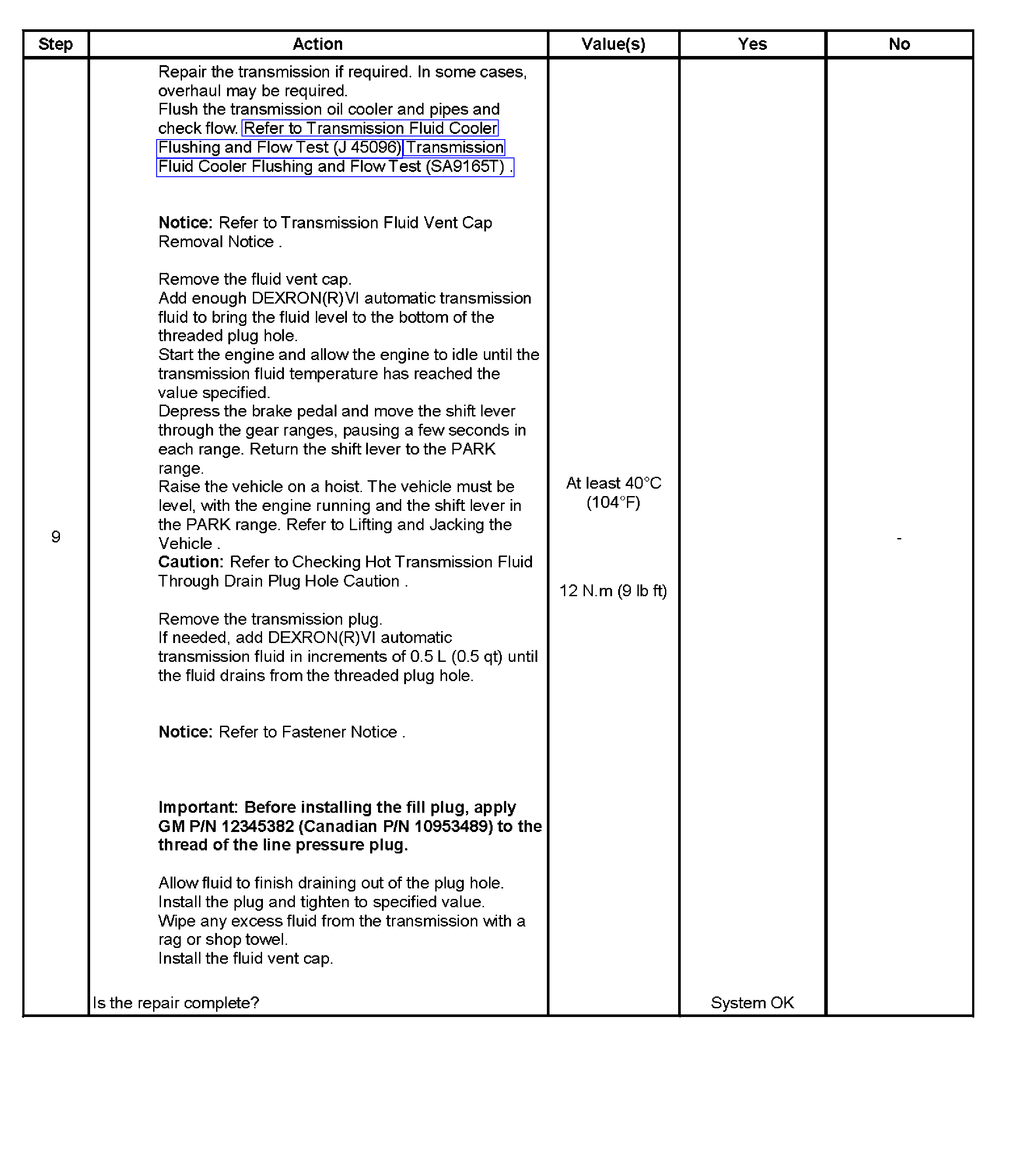

As you can see, it can get involved. What I do suggest is to check the transmission fluid and level to see if that can be causing a pressure issue.

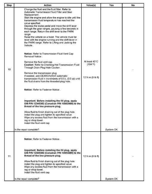

The directions for checking, adding and so on are basically located in the pics starting with number 2. Here are the few words they added.
Transmission Fluid Check
pic 2
The oil level control plug (65) is located on the torque converter side of the transmission.
Step 1 - Step 8
pic 3
Step 9
pic 4
Step 10 - Step 11
pic 5
_________________
Check that first and let me know what you find.

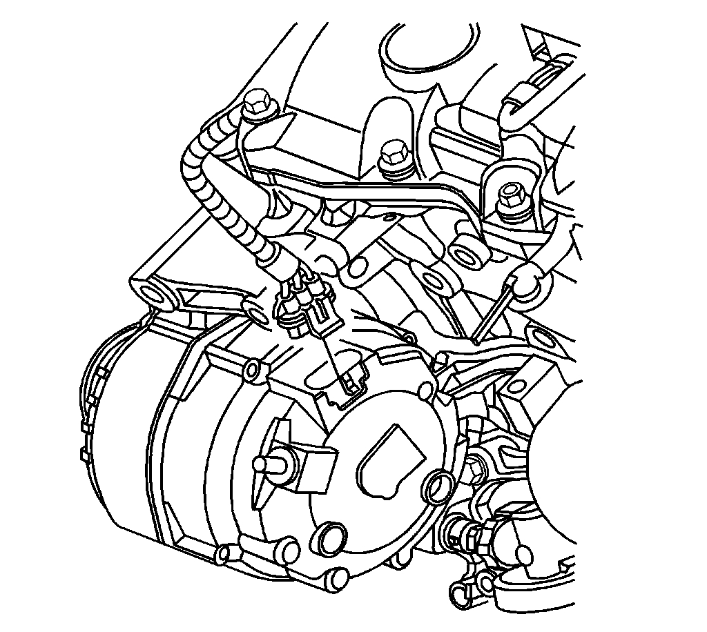

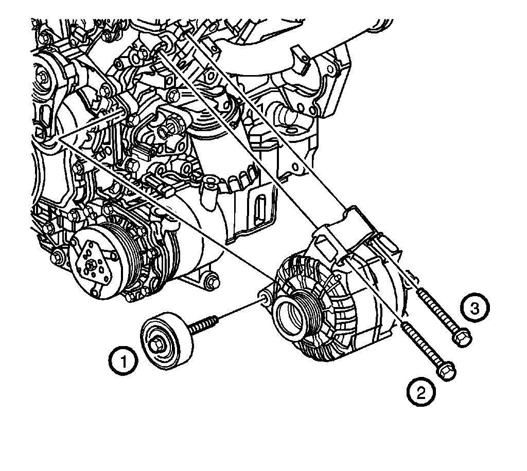

Here are the directions specific to your vehicle. The attached pictures correlate with the directions.

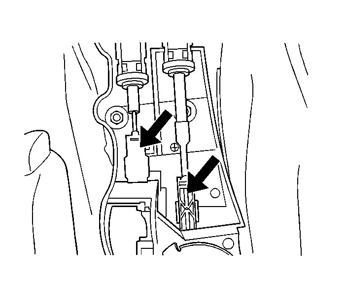

Generator Replacement (LY7)
Removal Procedure
pic 1
1. Disconnect the negative battery cable.
2. Reposition the positive battery cable boot at the generator terminal.
3. Remove the positive battery cable nut at the generator.
4. Remove the positive battery cable terminal from the generator.

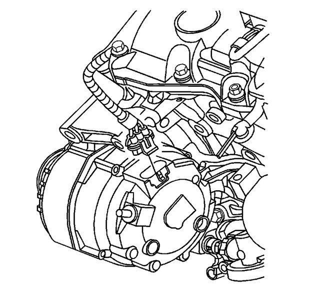

pic 2
5. Disconnect the engine harness electrical connector from the generator.
6. Remove the drive belt.
pic 3
7. Remove the idler pulley.
8. Remove the generator bolts.
Important: When removing the generator from the vehicle, it may be necessary to maneuver the generator to remove it from the vehicle.
9. Remove the generator.

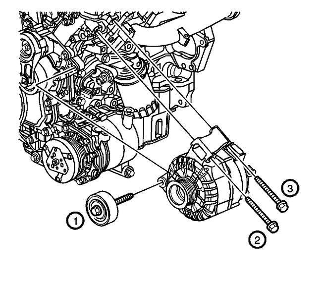

Installation Procedure
pic 4
1. Position the generator to the engine.
2. Loosely install the generator bolts.
3. Install the idler pulley.
Notice: Refer to Fastener Notice.
4. Tighten the generator bolts in the sequence shown.
Tighten the bolts to 50 N.m (37 lb ft).

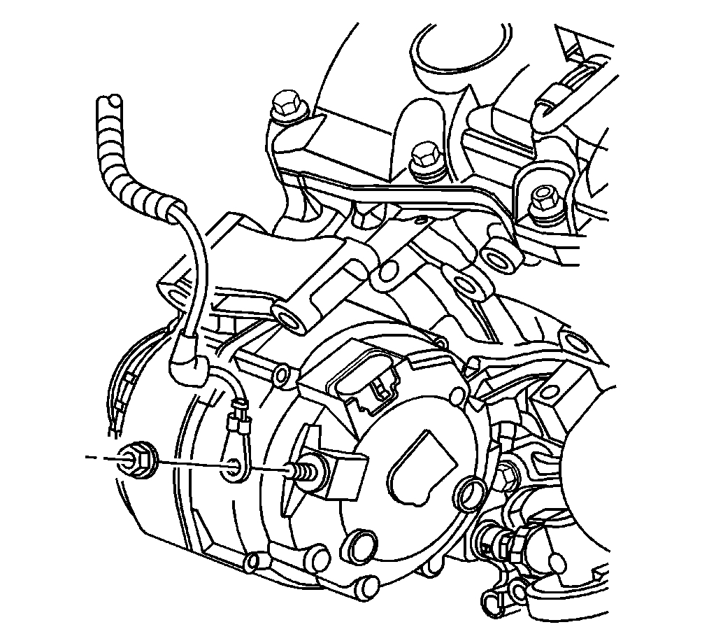

pic 5
5. Install the drive belt.
6. Connect the engine harness electrical connector to the generator.
pic 6
7. Install the positive battery cable terminal to the generator.
8. Install the positive battery cable nut at the generator.
Tighten the nut to 20 N.m (15 lb ft).
9. Position the positive battery cable boot at the generator terminal.
10. Connect the negative battery cable.
