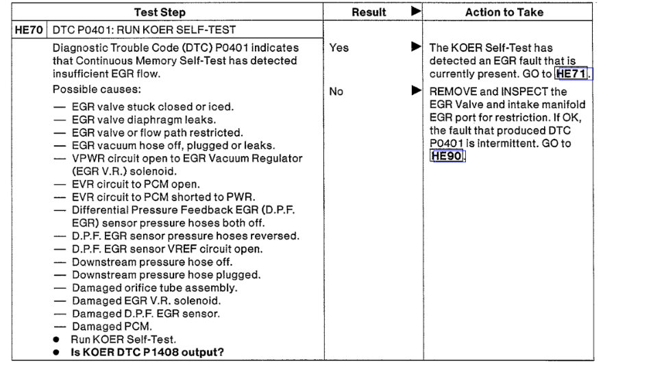

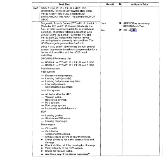

P1151 lack of h025s-21, h02s signal low input.
P0161 ho2s-22 bank 2 sensor 2 heater circuit malfunction.
P0401 insufficient EGR flow detected.
Apr 9, 2018 at 1:42 AM
the 401 is common for the delta pressure sensor.
Chart below.
Apr 9, 2018 at 2:21 AM
Okay.
1151 chart and possibilities below.
Apr 9, 2018 at 2:23 AM

That may be correct, but I have heard that because of the 02 sensor showing, that is what causes the EGR error.
Apr 9, 2018 at 2:24 AM
the 161 is for the ABS pump motor. it may be internally shorted.
Apr 9, 2018 at 2:26 AM
The 401 code, yes.
