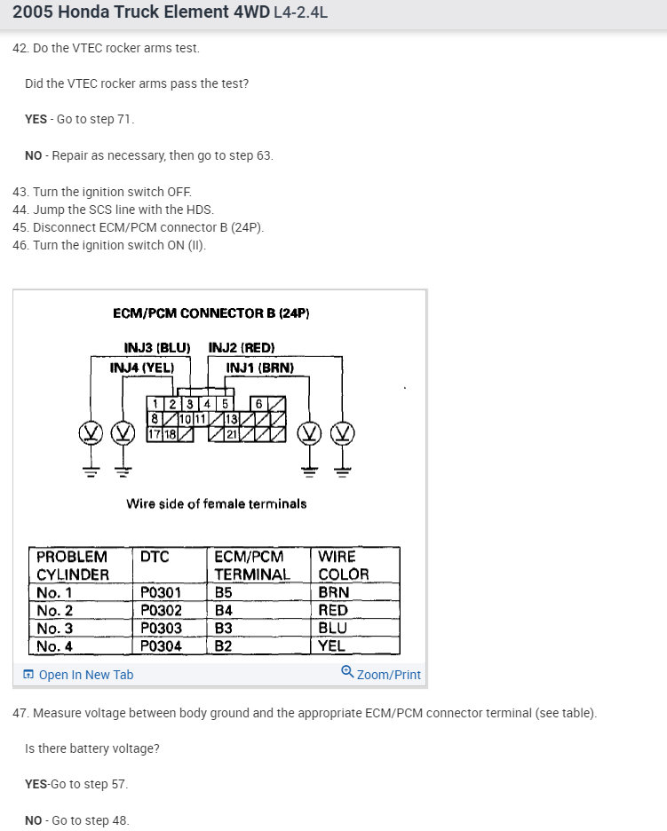

Code P0302, check engine light on?
2005 HONDA ELEMENT
159,000 MILES • 4 CYL • 4WD • AUTOMATIC
NAOMI.

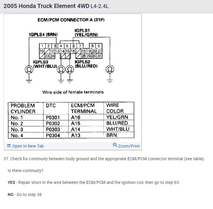

How do I find a mechanic who is competent to diagnose and fix this problem? The car is running fine, except maybe a little hesitation/running slightly rough when decelerating to a stop. It has plenty of "pep". Installing new spark plugs did not solve the problem.
Sep 19, 2022 at 2:15 PM
SQM
  • 6,383 POSTS

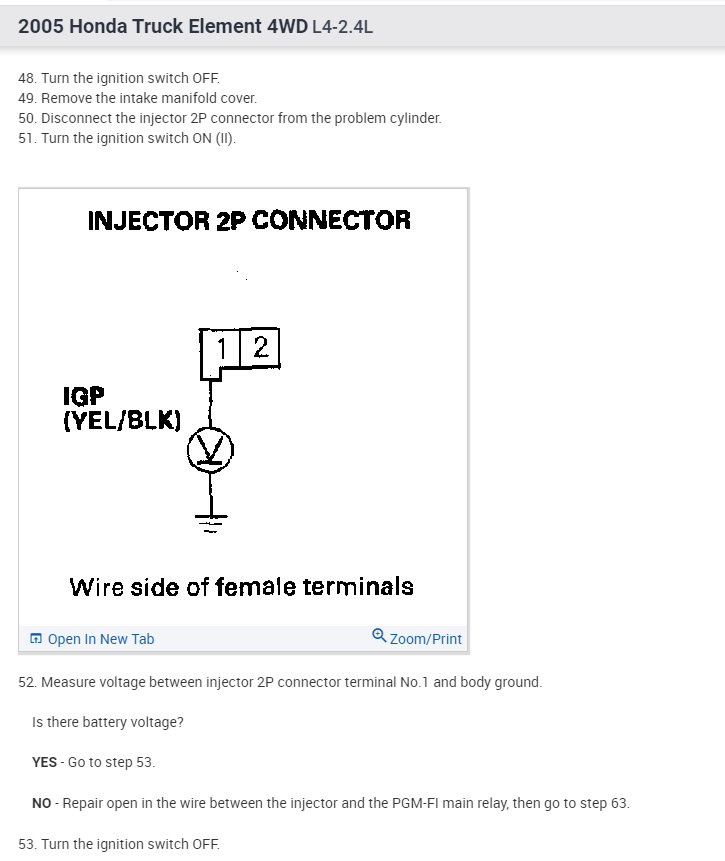

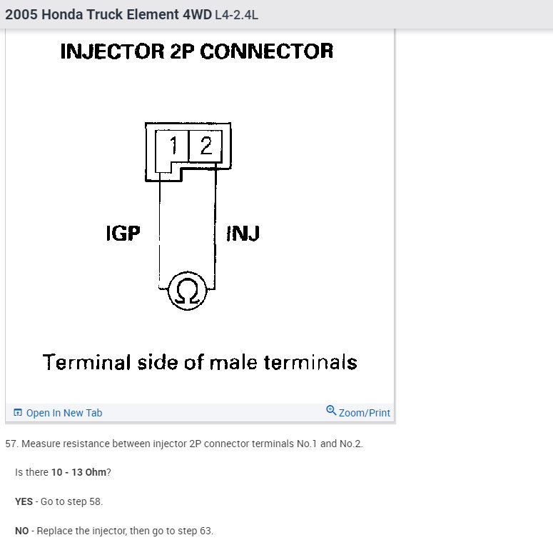

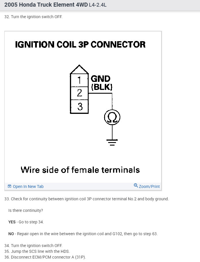

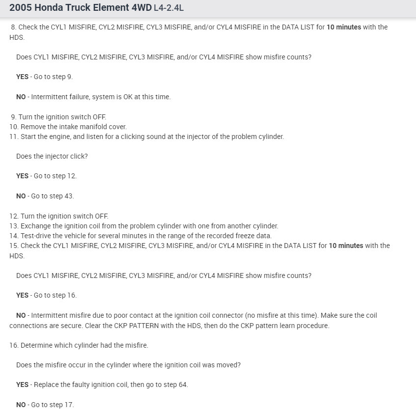

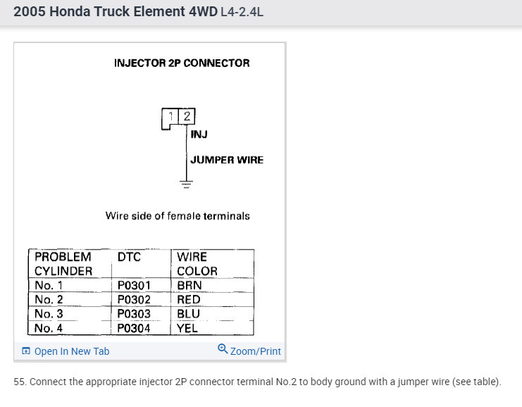

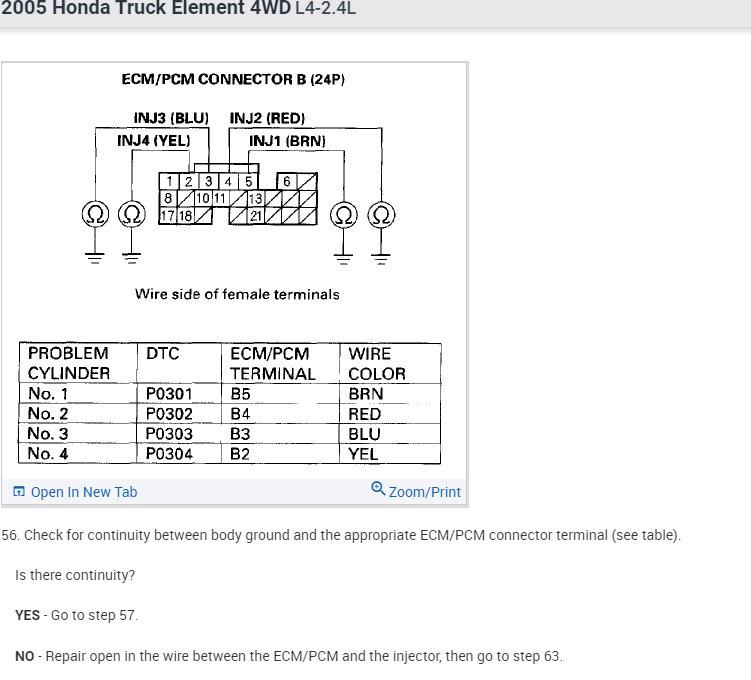

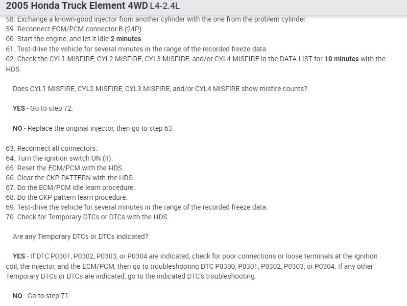

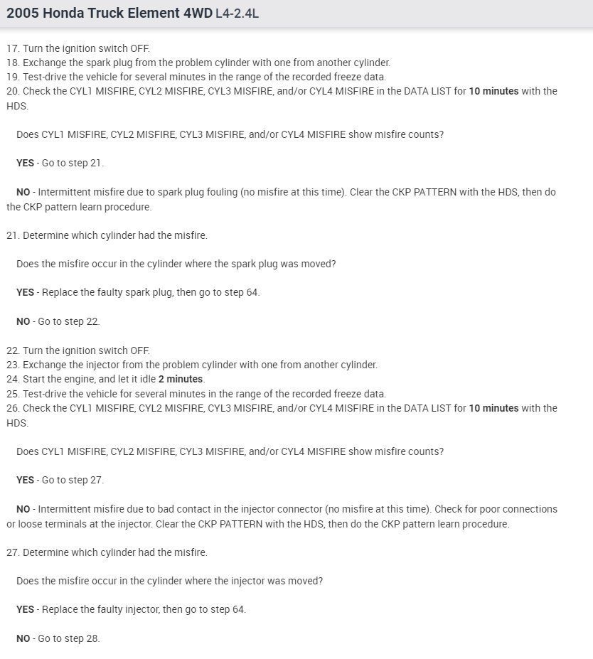

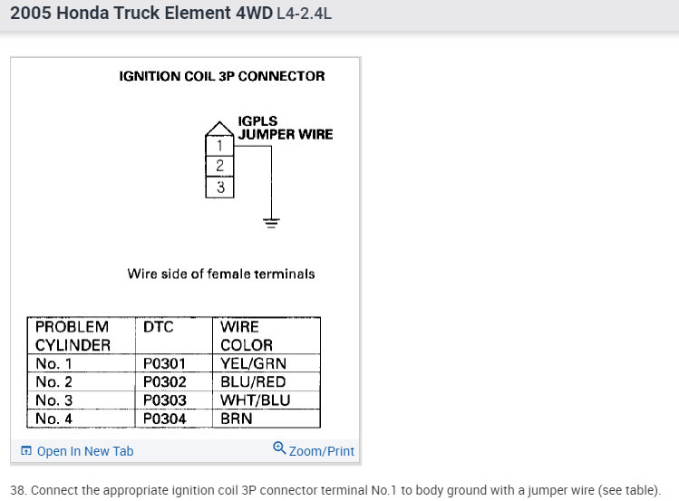

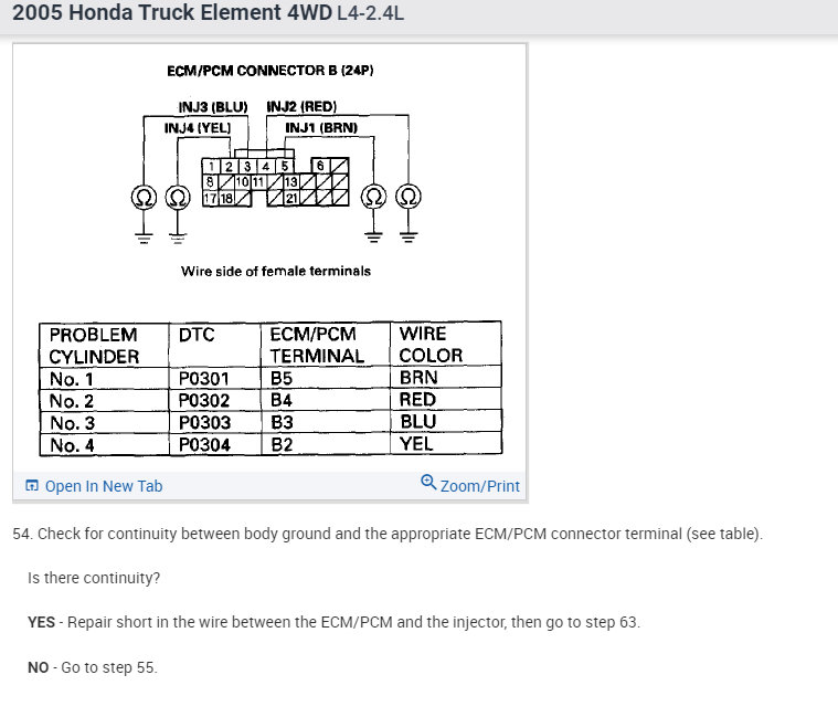

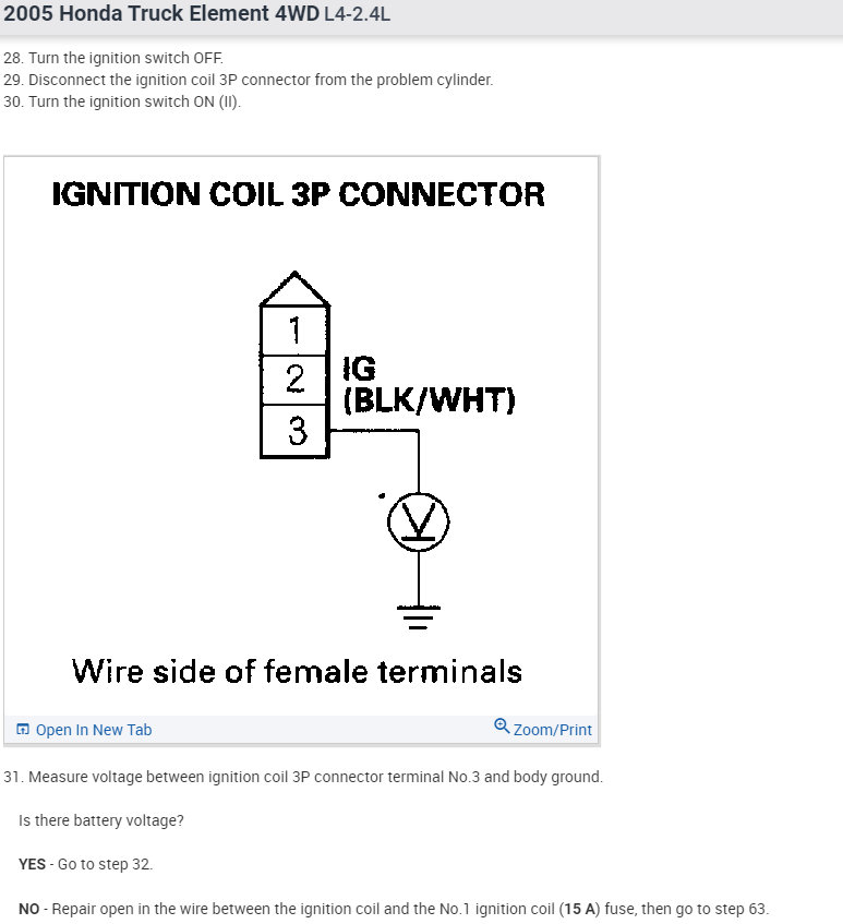

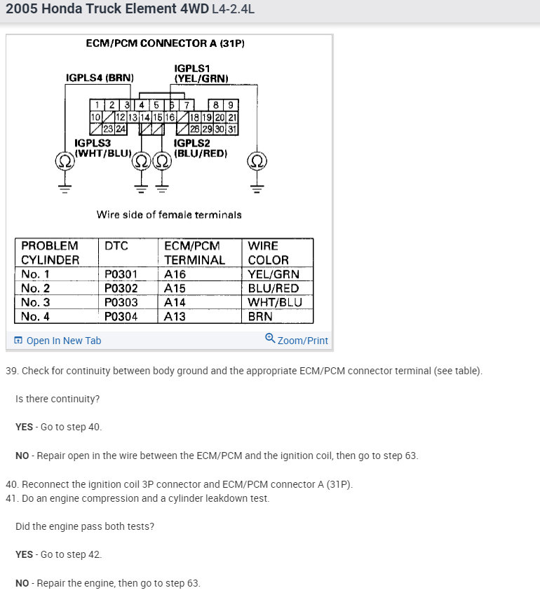

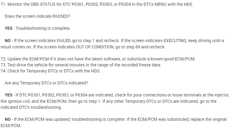

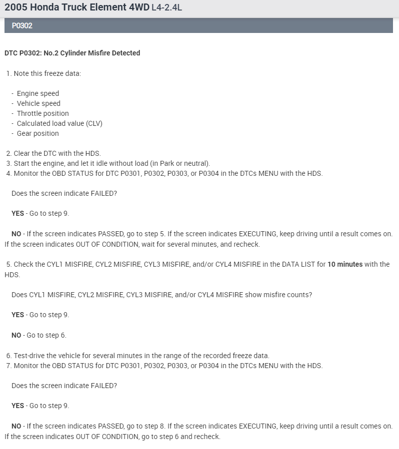

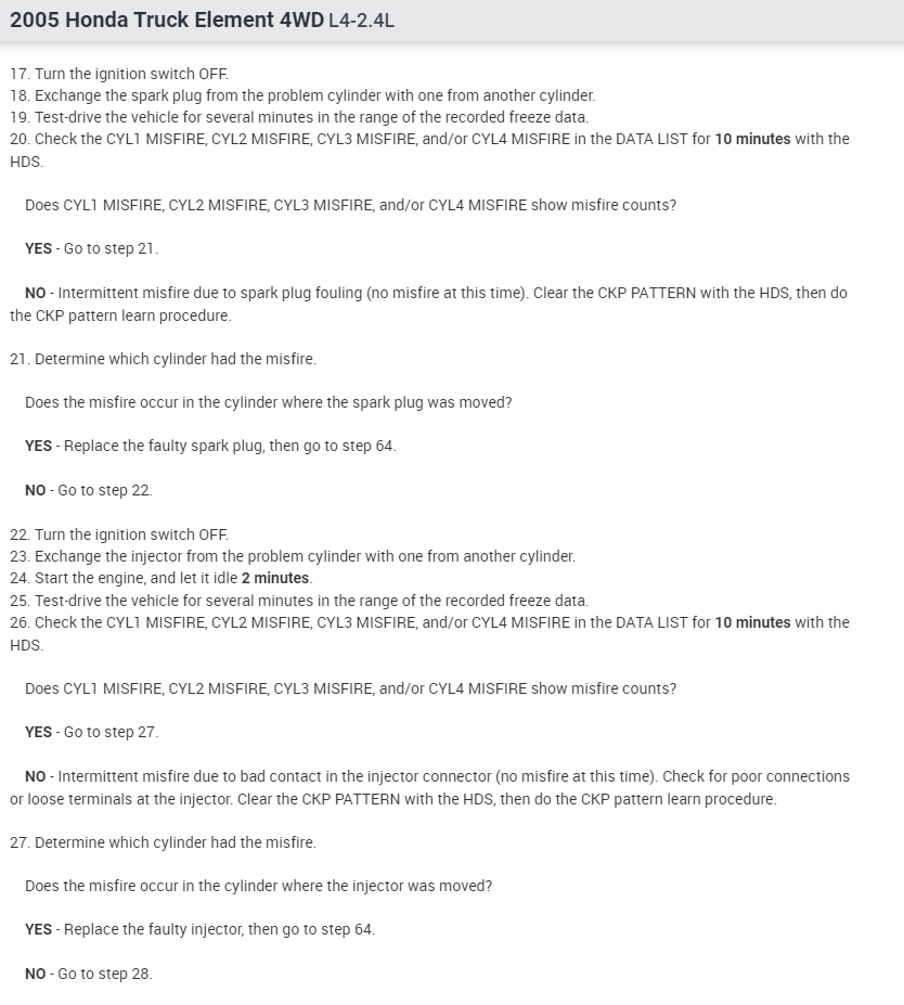

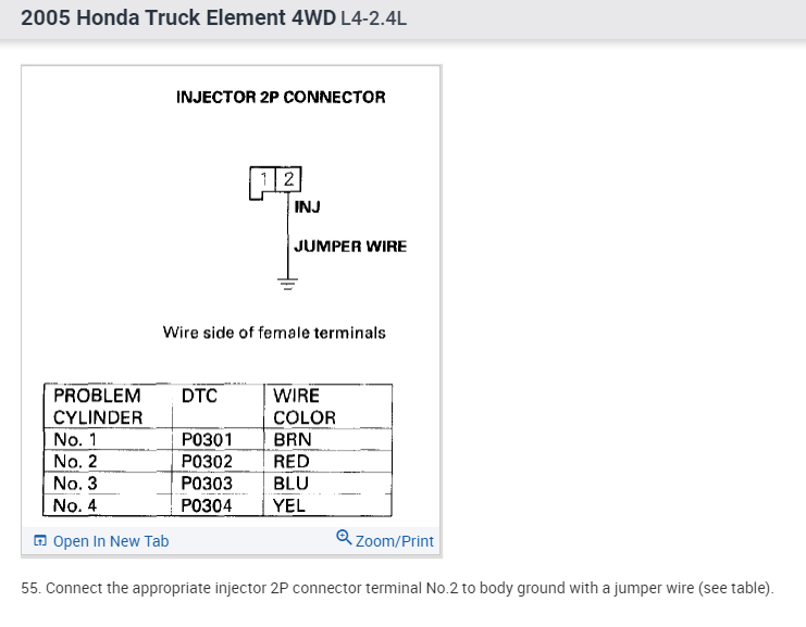

The code P0302 is due to misfire in cylinder two.
It could be simple as a worn spark plug.
It can also be due to a faulty injector or even the ECM.
Here is a helpful guide on how to diagnose engine misfire:
As for finding a good mechanic, you will have to just call around a few of the reputable local shops.
I have attached the diagnostic procedure for the code P0302 below for your reference.
Let me know of any questions.
