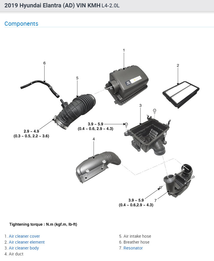

I think my air filter needs replacement! (29,000 miles).
Jun 22, 2022 at 3:36 PM
SQM
  • 6,383 POSTS
If the air filter hasn't been replaced since the vehicle was new, then yes it will need to be replaced.
However, a dirty air filter will not trigger the check engine light.
