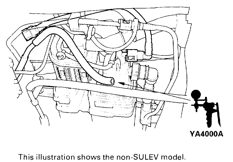

5. Check for a loose or damaged PCS line between the intake manifold and the EVAP canister purge valve.
Is the line OK?
YES - Go to step 6.
NO - Reconnect or repair the PCS line, then go to step 24.
pic 1
6. Disconnect the vacuum hose (A) from the EVAP canister purge valve (B), in the engine compartment, and connect a commercially available vacuum pump/gauge, 0-30 in.Hg (Snap-on YA4000A or equivalent) to the EVAP canister purge valve.
7. Do the EVAP PCS ON in the INSPECTION MENU with the HDS.
8. Slowly apply about 2 kPa (0.6 in.Hg, 15 mmHg) of vacuum to the hose.
Does it hold vacuum?
YES - Check for blockage in the PCS line between the intake manifold and the EVAP canister purge valve. If the vacuum hose is OK, replace the EVAP canister purge valve, then go to step 23.
NO - Go to step 9.

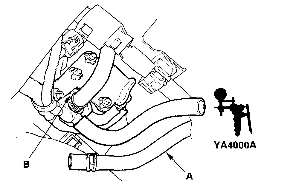

9. Reconnect the vacuum hose to the EVAP canister purge valve.
pic 2
10. Disconnect the vacuum hose from the PCS line (EVAP canister side), and connect a commercially available vacuum pump/gauge, 0 - 30 in.Hg (Snap-on YA4000A or equivalent) to the hose.
11. Do the EVAP PCS ON in the INSPECTION MENU with the HDS.
12. Slowly apply about 2 kPa (0.6 in.Hg, 15 mmHg) of vacuum to the hose.
YES - Check for a restricted in the PCS line between the EVAP canister purge valve and the EVAP canister, then go to step 23.
NO - Go to step 13.

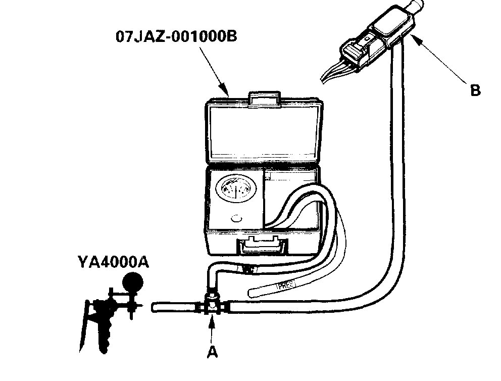

13. Remove the FTP sensor with its connector connected.
pic 3
14. Connect a T-fitting (A) from the vacuum gauge and the commercially available vacuum pump/gauge, 0 - 30 in.Hg (Snap-on YA4000A or equivalent) to the FTP sensor (B) as shown.
15. Check and record the FTP SENSOR reading in the DATA LIST with the HDS.
16. Slowly apply about 1.3 kPa (0.4 in.Hg, 10 mmHg) of vacuum to the hose.
17. Check the FTP SENSOR in the DATA LIST with the HDS.
Is the difference more than 1.1 kPa (0.31 in.Hg, 8 mmHg) before and after applying vacuum?
YES - Go to step 18.
NO - Replace the FTP sensor, then go to step 23.

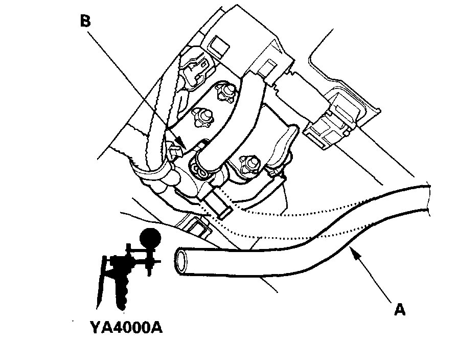

18. Reconnect the vacuum hose to the PCS line (EVAP canister side) and reinstall the FTP sensor.
pic 4
19. Disconnect the vacuum hose (A) from the EVAP canister purge valve (B), and connect a commercially available vacuum pump/gauge, 0 - 30 in.Hg (Snap-on YA4000A or equivalent) to the hose.
20. Do the EVAP CVS ON in the INSPECTION MENU with the HDS.
21. Slowly apply about 2 kPa (0.6 in.Hg, 15 mmHg) of vacuum to the hose.
Does the hose hold vacuum?
YES - Check for blockage at the EVAP canister port, then go to step 22.
NO - Replace the EVAP canister vent shut valve, then go to step 22.
