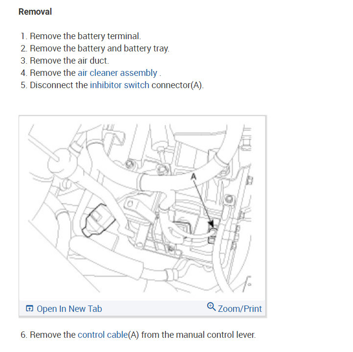

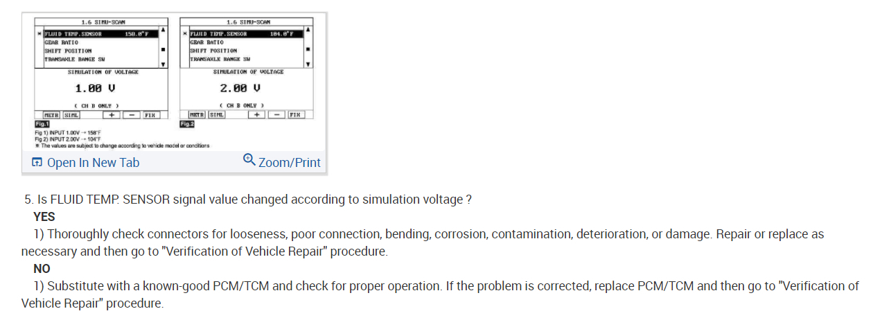

The check engine light is on and the codes that come up are P0880, P0713, P0707, P0700. Where do I begin to look for this problem? Is there a specific test that I can do? All help is appreciated.
Jun 3, 2021 at 7:38 PM
Good morning,
The 700 is a general code indicating there are transmission codes. This is an information code.

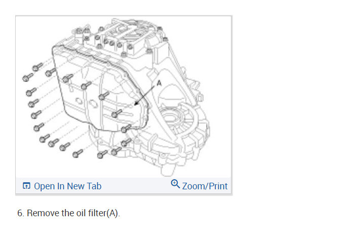

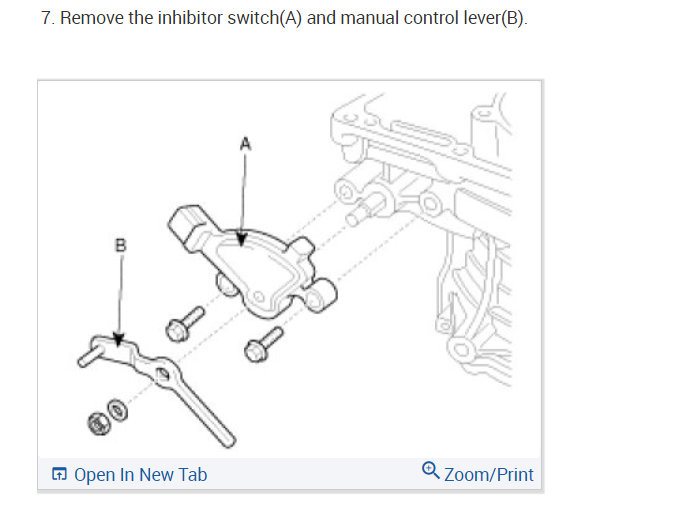

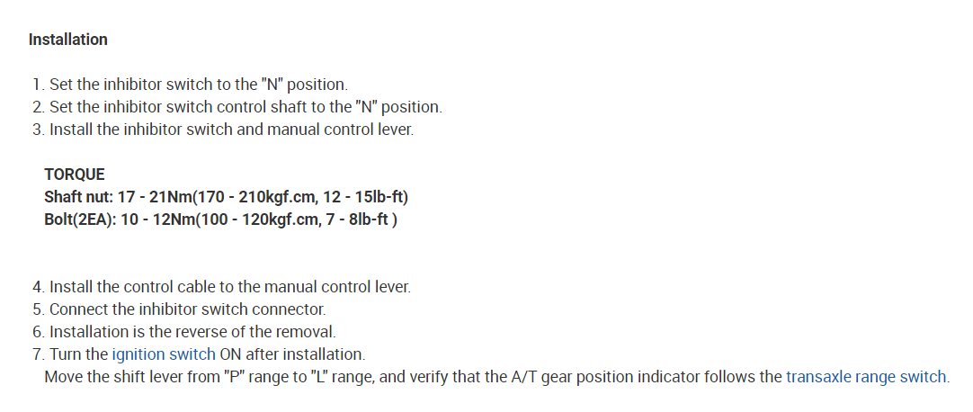

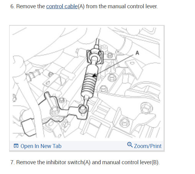

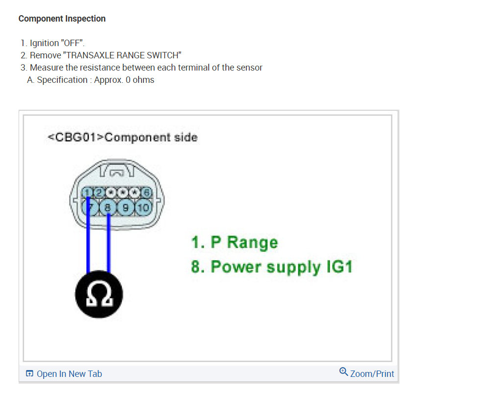

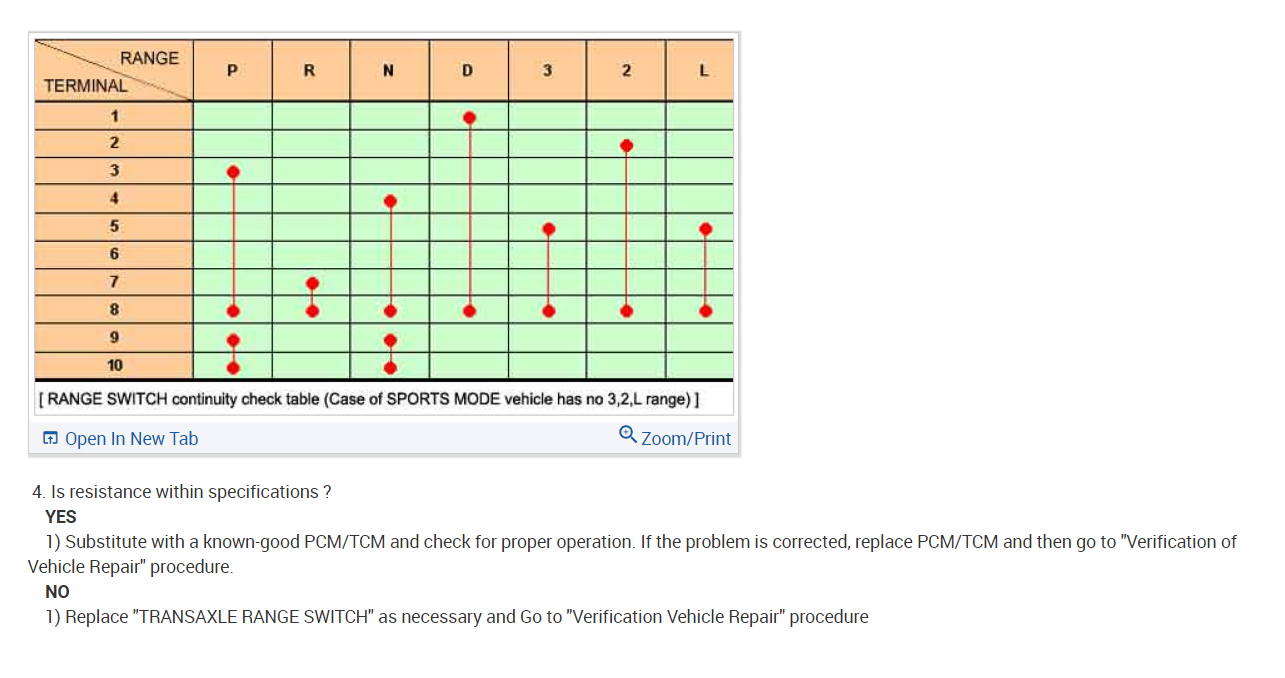

The 707 is for the range switch on the transmission. I attached the flowchart for checking it to verify if it is the switch or wiring. In most cases, it is the switch.

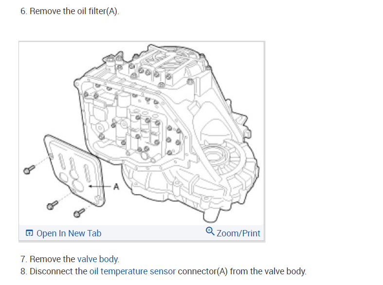

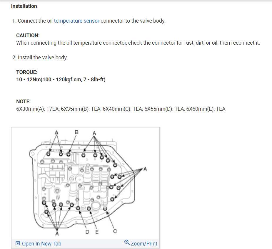

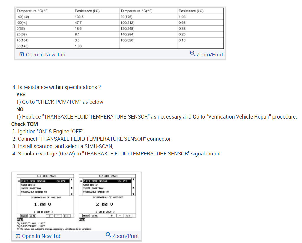

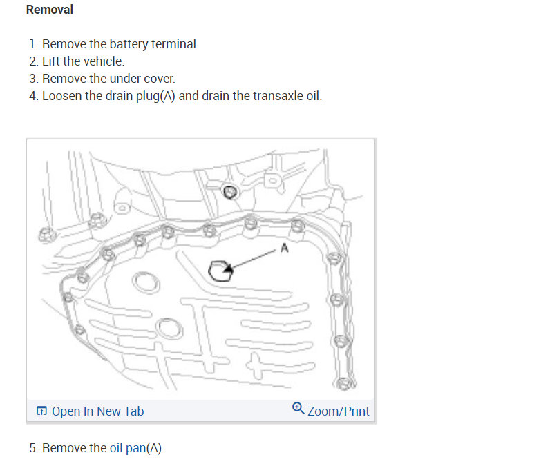

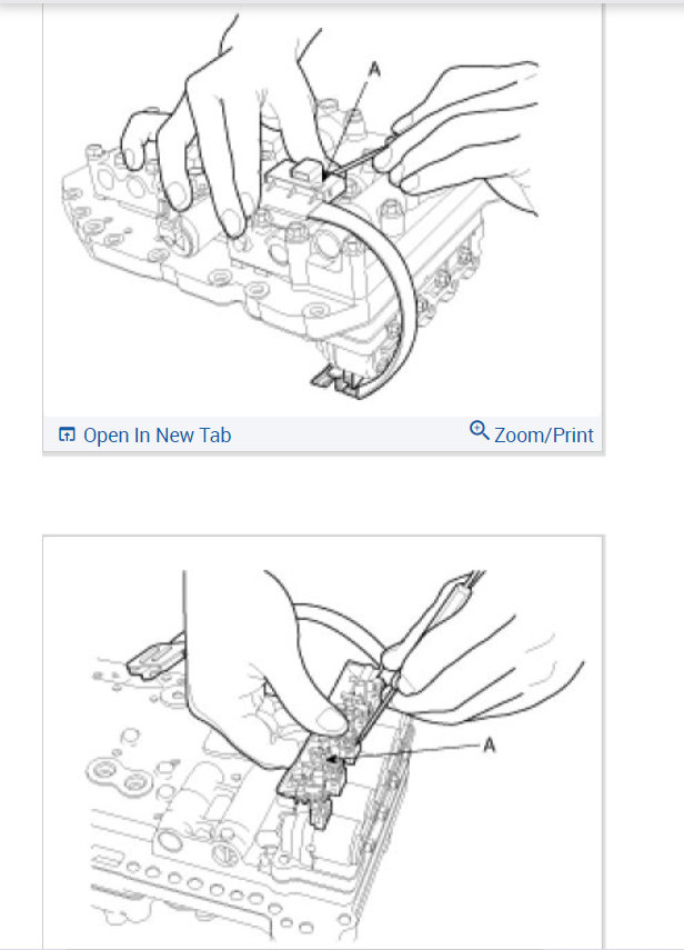

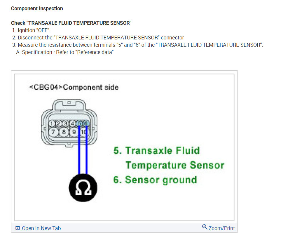

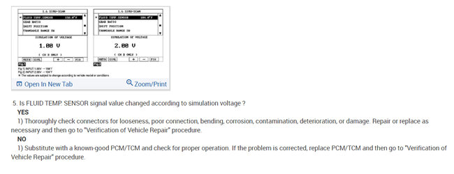

The 713 is for the temperature sensor for the fluid. I also attached the flow chart for this as well.
You need to test to verify the failure. In most cases, it is the components themselves.
There is no P0880 listed. Can you please verify the last code for me?
