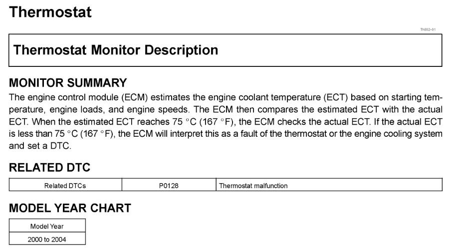

I got it computer scaned, and the code said that I had the wrong coolant thermostat. Code P0128
May 14, 2019 at 1:36 AM
  • 110,248 POSTS
Welcome back:
I attached in picture form the exact definition of the code for you to see. In this case, chances are the thermostat is either sticking open and not allowing the engine to warm up in an allotted amount of time, or even the sensor itself may be going bad. Take a look at the pic I attached. If you already got it taken care of, great. If you haven't, let me know if I can help.
