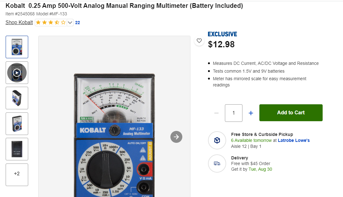

I wouldn't spend too much on one if you won't use it in the future. I found one at Lowes for 13 dollars. This would more than do the job for you.
I attached a pic below. I don't know where you're located, but if there is a Lowes near you, this would be good for you. You can also order them online.
I still have an older Motorola analog meter that still works great. That would be a good brand as well. Mine is 30 years old. LOL
I hope this helps.
See pic below.

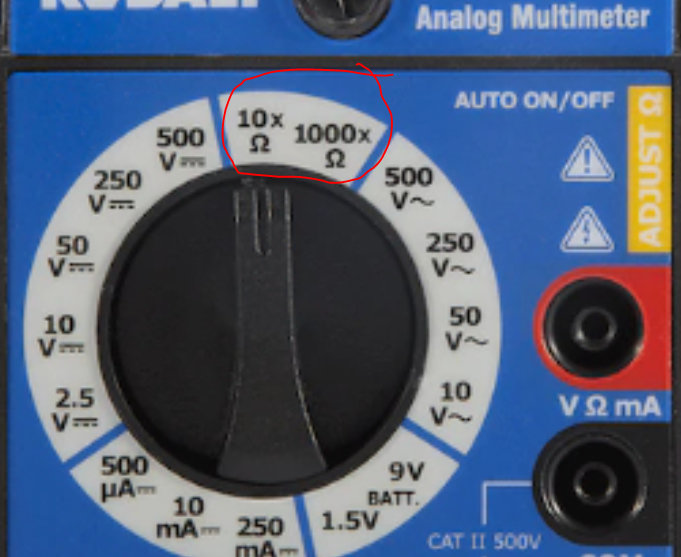

Sorry for my usual delays but I finally bought the Analog Multimeter you suggested but I don't see where I set it to continuity. Can you please let me know how to do that?

No problem. I attached your pic below and circled the two settings for resistance (Ohms) That is what is used to check for continuity.

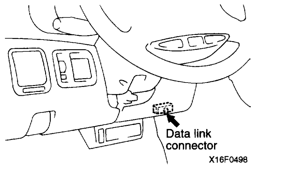

I do not like to be such a pain, but I cannot find the connector anywhere on the 1994 3000GT. Any idea where it could be? I can't seem to find it anywhere need the fuse box or surroundings.

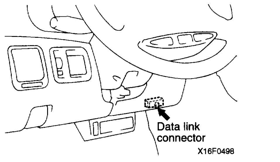

The DLC is located on the left side of the vehicle's passenger compartment under the dash. I attached two pics below. Let me know if you are able to find it.
Sep 25, 2022 at 6:55 PM

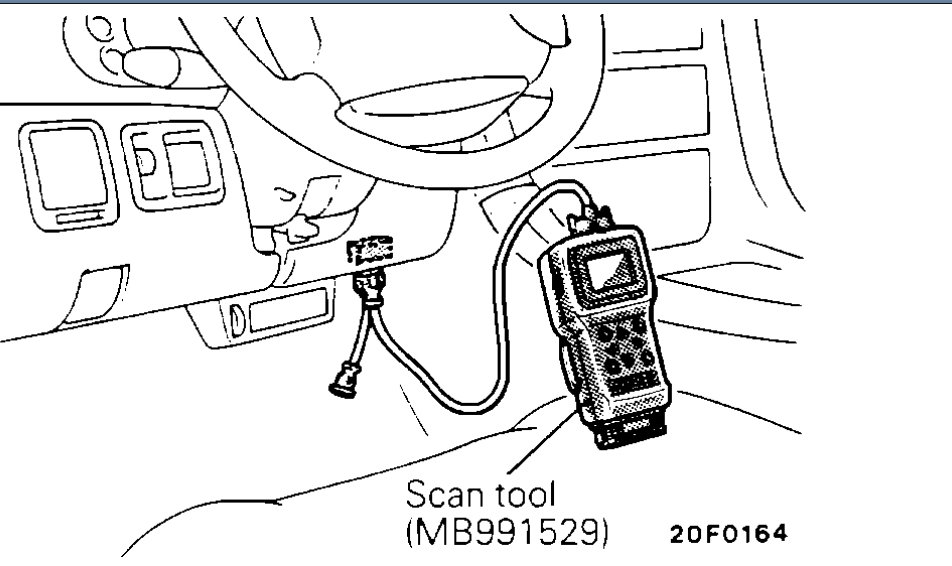

I believe that I can touch under the dash where you have indicated and feel the unit. However, I am disabled and trying to get under the dash is impossible for me. You almost have to be a contortionist. Can this unit be dislodged or is it there permanently? Without a OBD1 to hook it up, I don't see being able to get under the dash to use the voltmeter.
Any ideas on where I can buy a Mitsubishi OBD1 unit?

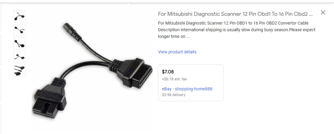

Wow, it may be hard to get one. Some OBD2 scanners can be used on OBD1 but they require a connector to go from the 12-pin OBD1 port to a 16-pin OBD 2 scan tool.
The connectors are really inexpensive, but your scanner needs to be able to do this. A basic scan tool will likely not do it.
Let me know if that helps. Also, I attached a pic from eBay of what I'm referring to.
See pic below.
