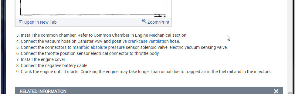

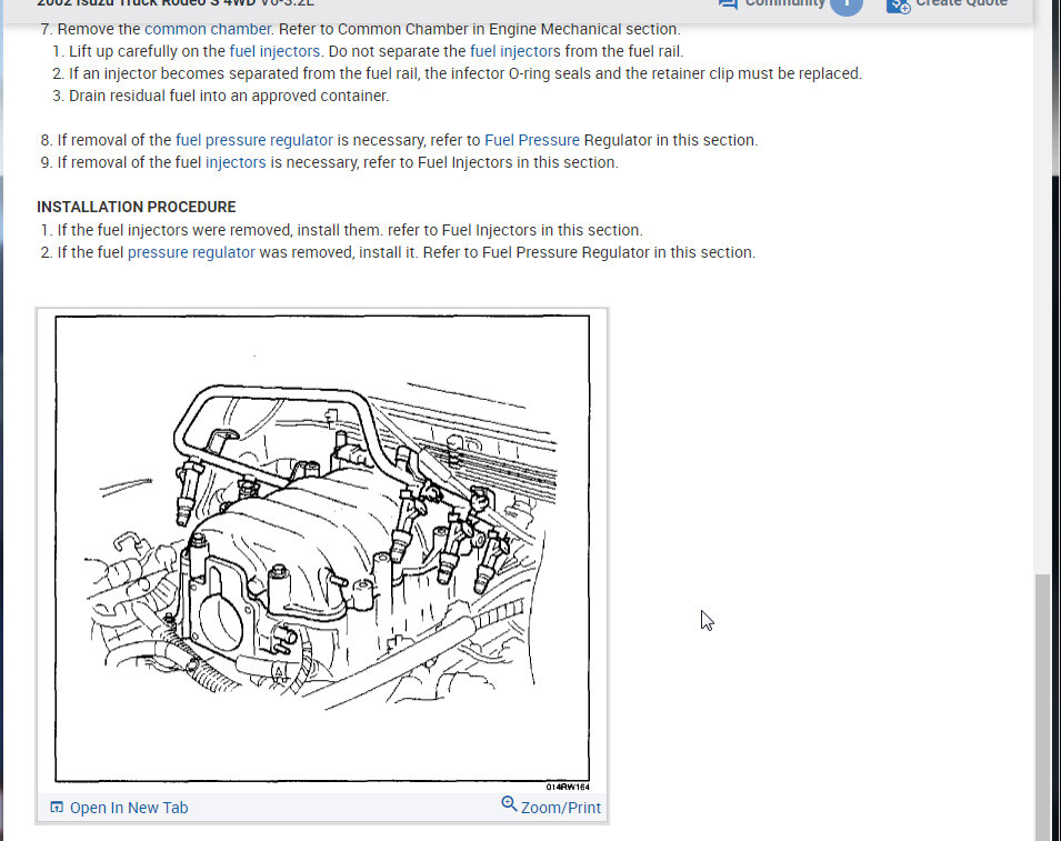

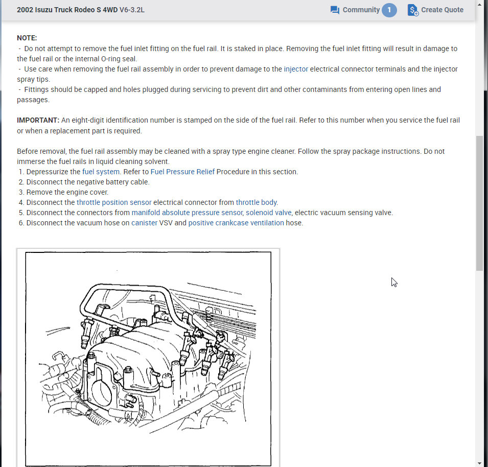

Couple things. First we need to start with checking the compression on this engine as well. Here is a guide that helps with this:
Then we need to know know if you swapped the fuel rail over from the old engine or was it with the replacement engine? If it came with the replacement engine, let's check the fuel pressure when this is happening.
I have seen a couple times where the fuel rail is clogged or restricted and it causes these types of issues.
Below is the process for how to replace the rail. Let us know what questions you have. Thanks
