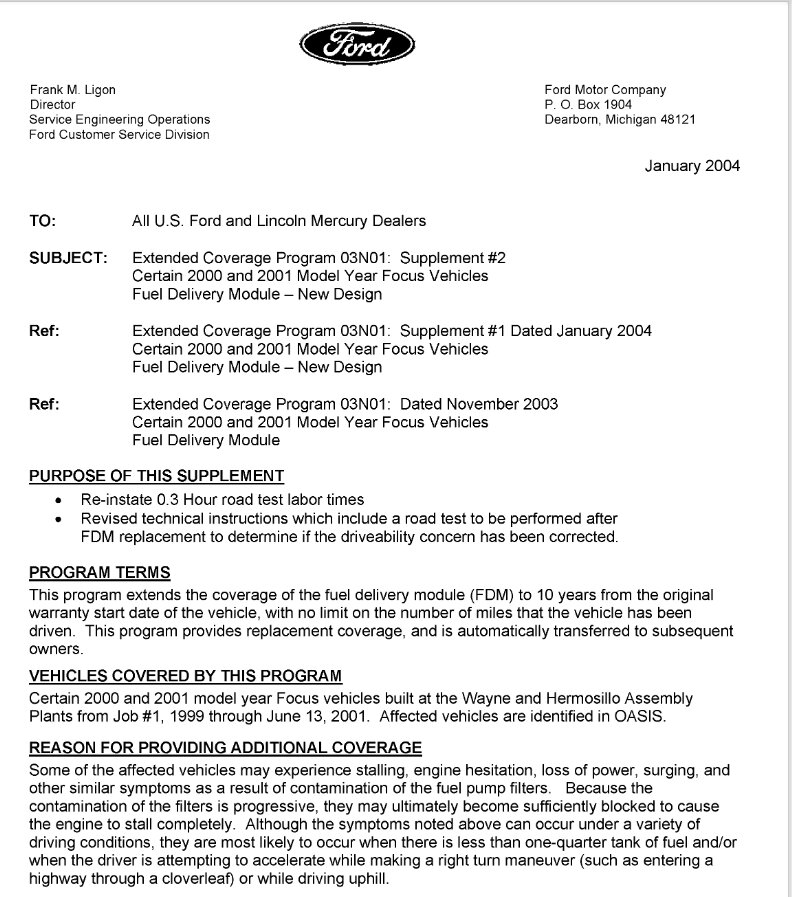

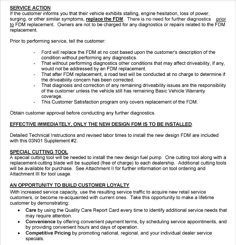

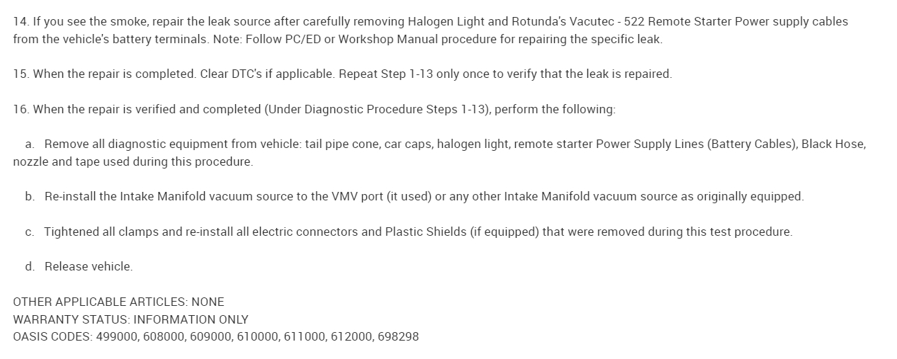

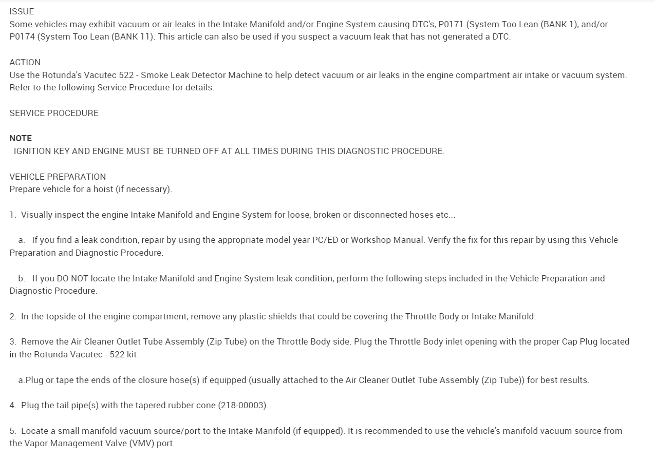

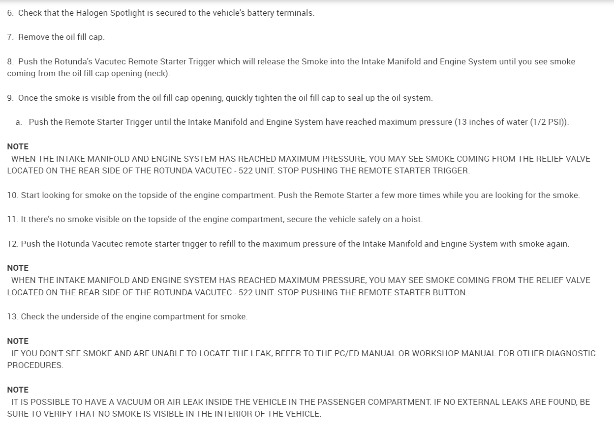

There was a Recall on the Fuel delivery module, for a new design. This is way back from 2004, but shows they had a problem with the fuel system, and low fuel volume can cause a lean code.

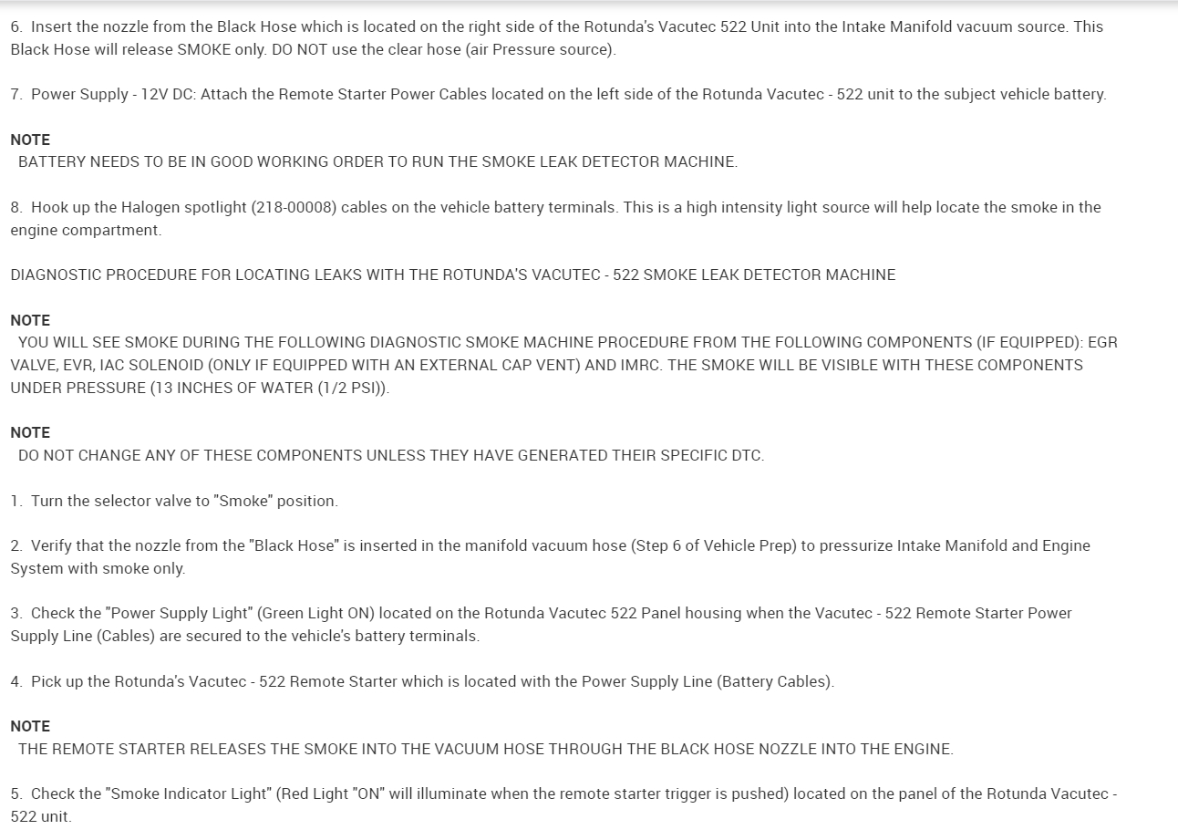

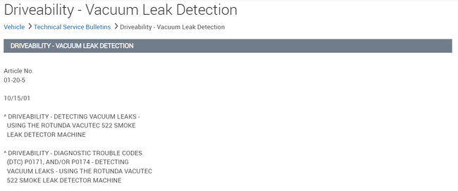

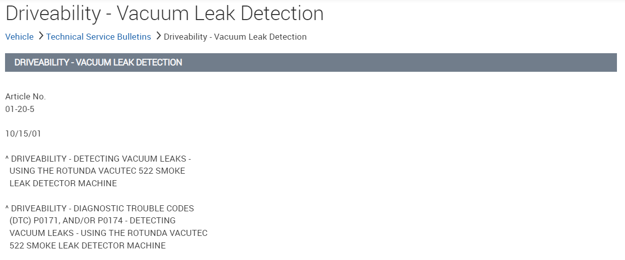

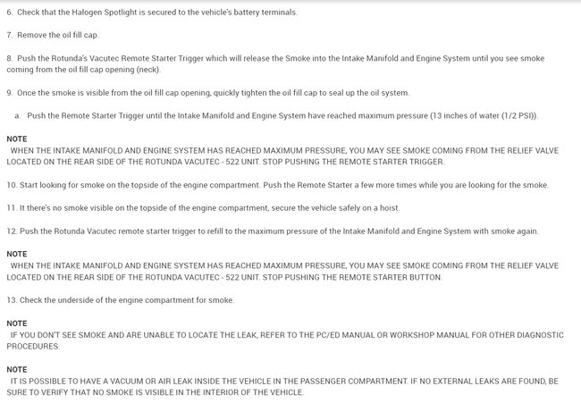

There was also a Technical Service Bulletin on Vacuum leak detection, pages 3 to 7 below.
