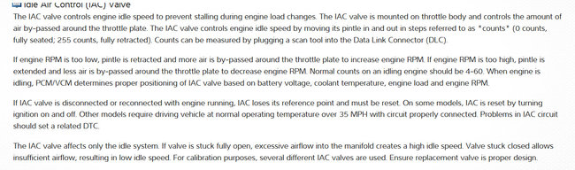

idle air control motor which is mounted on throttle body. it controls the idle of car and is normally a small oblong hole on throttle body you can see it when duct work is off of throttle body.

it controls the idle on the motor by opening or closing shutting off or letting more air in by how computer tells it what to do. See picture for description of operation I assume that is what you are meaning by "downhill".
