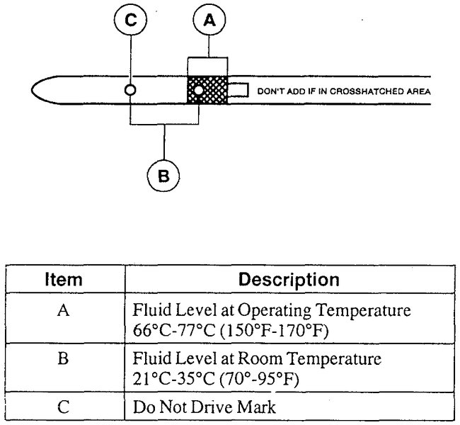

Okay, was the transmission fluid checked for condition and level? I made the assumption that was what was changed. Lets start there. Here are directions for checking level and condition. The attached pics correlate with the directions.

pic 1
4. Pull the fluid level indicator out of the fluid fill tube again and check the fluid level.
If necessary, add enough fluid through the transmission fluid fill tube to raise the level to the correct position. Do not overfill the transmission. This will result in foaming, loss of fluid through the vent and possible transmission malfunction. If overfill occurs, excess fluid must be removed.
5. Install the fluid level indicator, making sure it is fully seated in the fluid fill tube.
If the transmission fluid level is checked when the fluid is at ambient temperature, the fluid level indicator could indicate that fluid should be added if the fluid level indicator is misread. If fluid is added at this time, an overfill condition could result when the fluid reaches operating temperatures of 66° C-77° C (150° F-170° F) (fluid level indicator hot to touch).
Underfill can result in transmission loss of engagement or slipping. This condition is most evident in cold weather or when the vehicle is parked or being driven on a hill.
If the transmission fluid level is correctly established at 10-35° C (50-95° F), it will appear in the HOT marked area on the fluid level indicator when the transmission reaches an operating temperature of 66-77° C (150-170° F). Do not overfill or underfill.

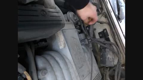

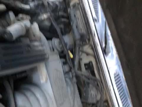

That’s what I found.

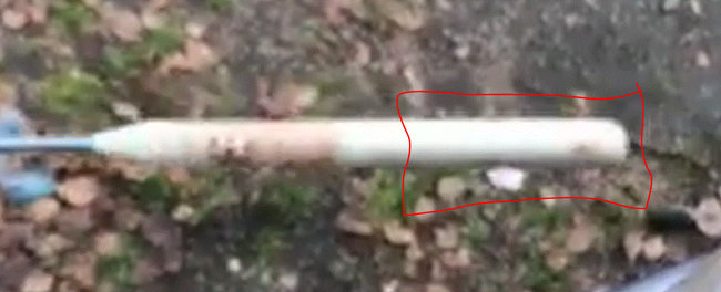

I can't tell for sure, but it looks like the stick is dry indicating low fluid. Is that correct?
Oct 8, 2020 at 11:15 AM
JAY-12849
  • 5 POSTS
I really don’t know??
Oct 9, 2020 at 6:38 PM
  • 110,240 POSTS
I copied a pic from your video. There should be transmission fluid on the stick where I circled. It should reach to the cross hatches on the stick. If you look at the pic I attached earlier, it will indicate where the level on the stick should be.
Start the engine and allow it to reach operating temp. With the engine running (idle) and in park, remove the dipstick from the transmission and see if there is any fluid on the stick. It will be reddish in color.
If there is nothing on the stick, that is likely the problem. Hopefully it isn't too low.
