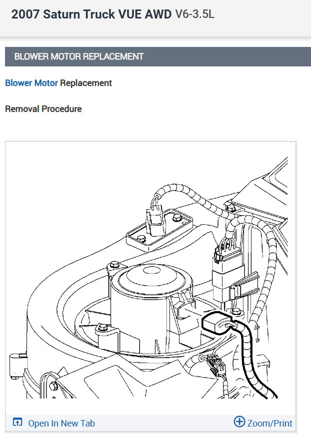

Why does a check engine light come on when I turn the heat on, it comes on when I turn the blower or fan on?
Nov 2, 2024 at 6:03 AM
  • 55,433 POSTS

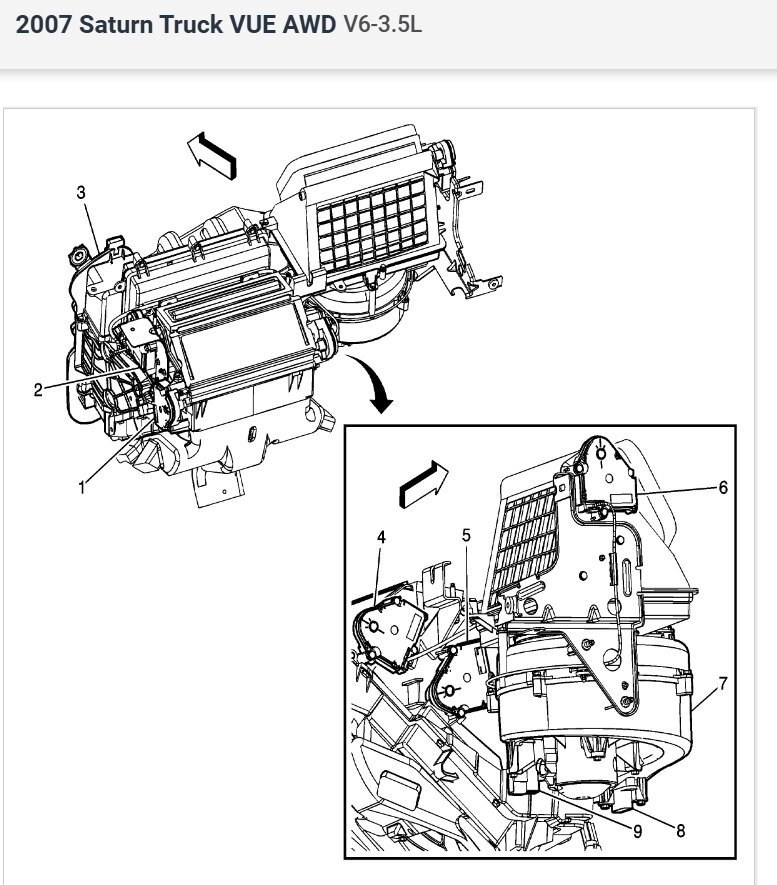

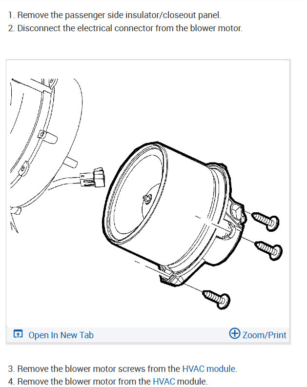

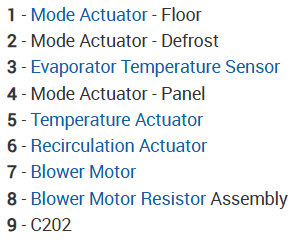

It sounds like you have an alternator that might be bad or the blower motor is pulling too many amps. We will know for sure if you run the codes to see which ones are stored. Please go over this guide to help you see which codes they are so we can fix the car.
Here is the blower motor location in case you have a low voltage code. Please go over this guide and get back to us.

I actually have no idea what those diagrams are and what I'm supposed to do with it, lol. I did a scan, and it had code p0705.
Nov 2, 2024 at 10:37 AM
  • 55,433 POSTS
It just shows what needs to be done to check out the problem so you have an idea of what the repair will entail. This code should not have anything to do with the blower motor.
The P0705 code on a 2007 Saturn Vue indicates an issue with the Transmission Range Sensor (TRS) Circuit.
Could it be that the blower motor operation is just a coincidence? Just it has the problem each time you turn the blower motor on, can you please shoot a quick video with your phone so I can tell for sure what's going on. You can upload it here with your response.
