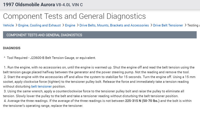

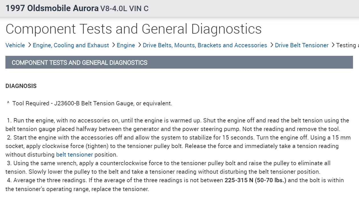

Hello again,
Okay, this could be a problem with the serpentine belt tensioner. In the diagrams down below I have included the factory guidelines for testing and inspection of your vehicle's serpentine belt tensioner. Please go through the guide and get back to us with what you are able to find out.

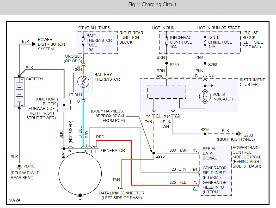

  • 55,395 POSTS
I have seen the instrument cluster cause this problem. here is a wiring diagram to show you how the system works and a video that how the cluster being replaced in a similar car:

  • 55,395 POSTS
Can we check to see if the alternator is working? here is a guide. The battery light is run through the cluster and can go bad leaving the battery light on.
