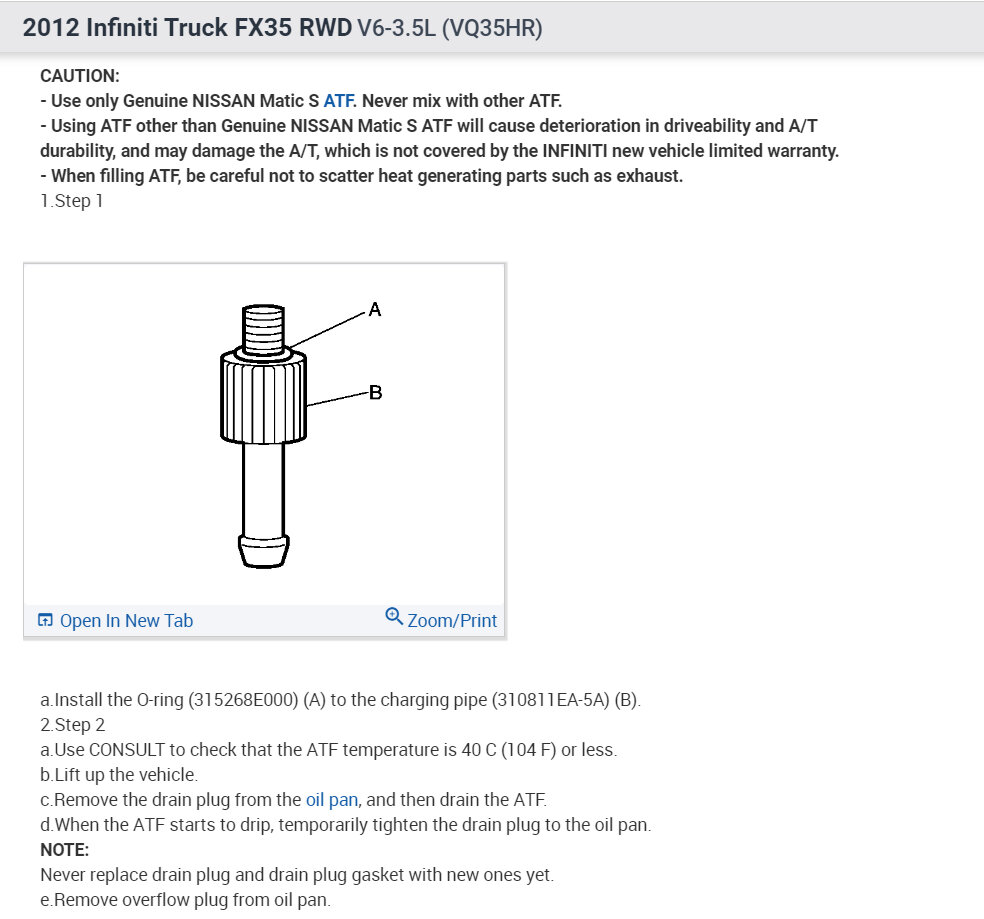

How do you do that, drain and fill? how much fluid approximately and do I check the fluid once changed while car is running or turned off?
Oct 11, 2022 at 7:57 AM
  • 55,395 POSTS

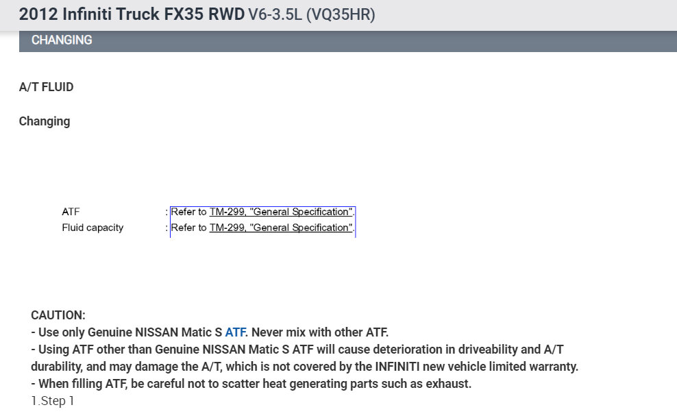

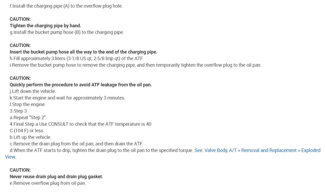

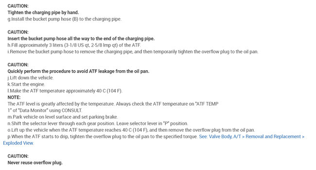

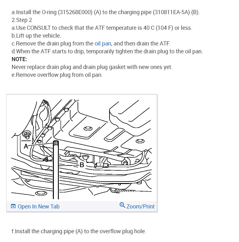

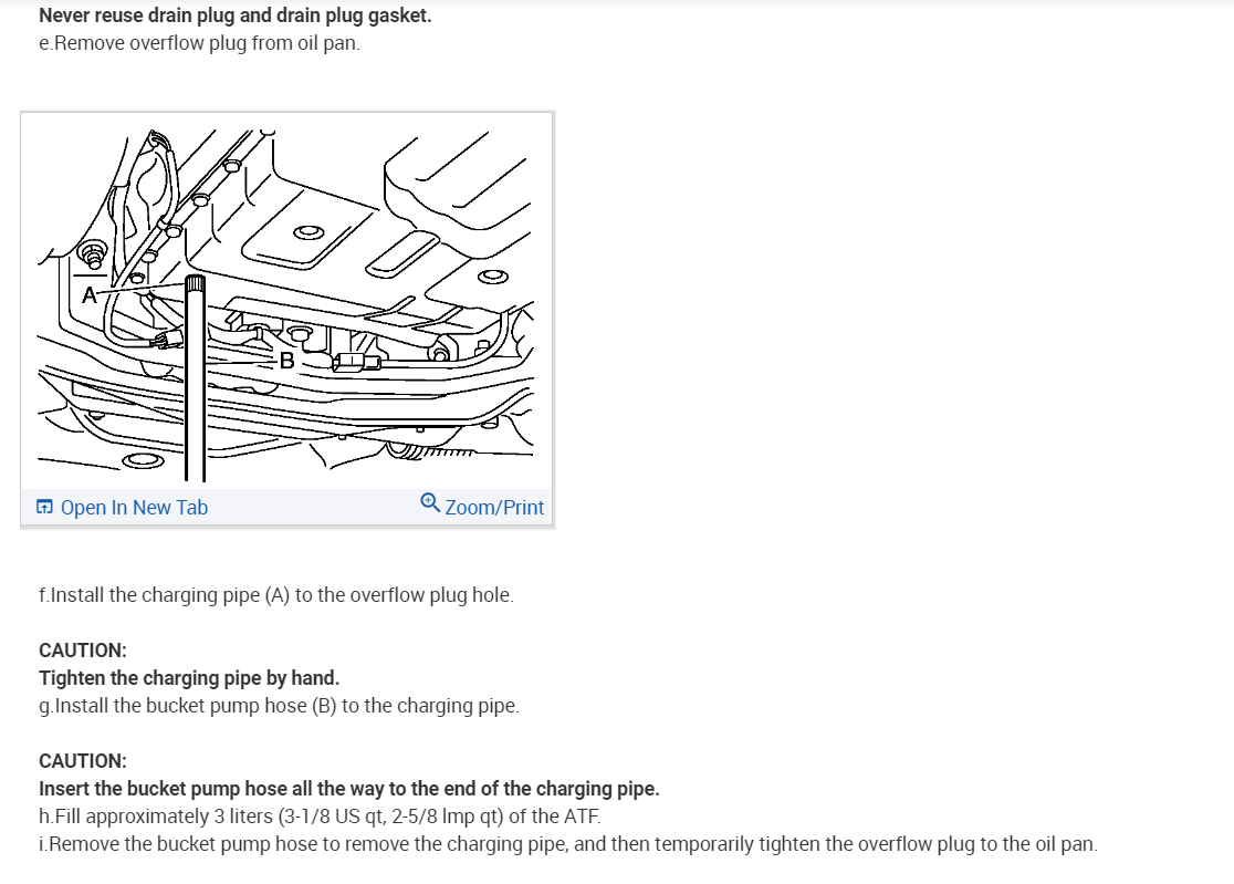

Yep, here is the fluid type and how to change the fluid out with a generic guide for you to go over which will walk you through the steps with instructions for your car in the images below. Also, you have to use their fluid, or the transmission will not work.
Fluid Types
Automatic Transmission Fluid
Type .................... Genuine NISSAN Matic S ATF
Using automatic transmission fluid other than Genuine NISSAN Matic S ATF will cause deterioration in drivability and automatic transmission durability, and may damage the automatic transmission, which is not covered by the Infinity new vehicle limited warranty.
Capacities
Capacity* .................... 9-3/4 qt (9.2L)
*The fluid capacity is the reference value.
Check out the images (below). Please let us know if you need anything else to get the problem fixed.

I do not understand this. I took off the drain plug and nothing came out. No leaks from pan or anything else. Is there another plug inside? I have an adapter to fill which screws in the place where the drain plug threads. But am sure some fluid must come down.
Oct 14, 2022 at 4:22 AM
BHAMDOC1973
  • 2,007 POSTS
I got it done. I missed the bigger 19 mm bolt in the pan to drain. Drained 3 qts, and to fill inserted a hose in the hole of the smaller Allen key bolt up front and added 3 qts. Thanks
