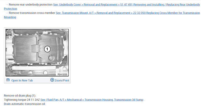

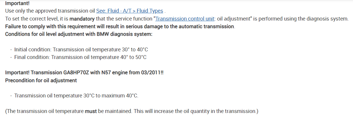

Changed many BMWs' ATF before just wanted to see if there is any procedure that is different on this one as well as what type of fluid to use and capacity for a drain and fill. Also, if you can find the temperature to check the level.

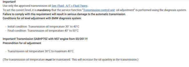

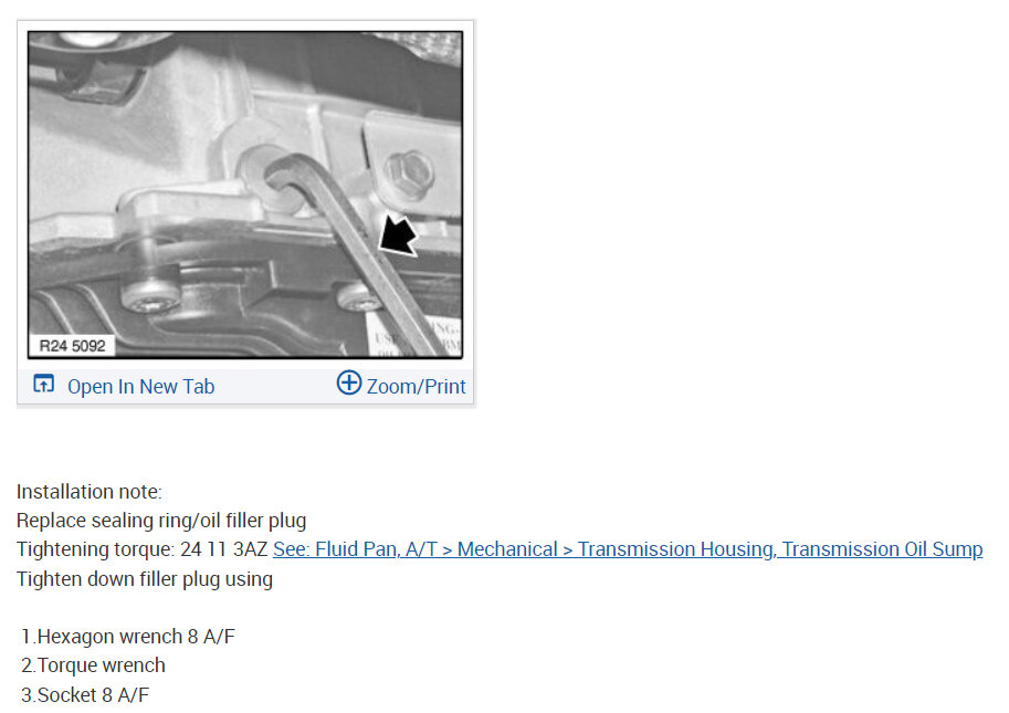

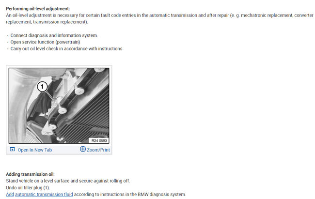

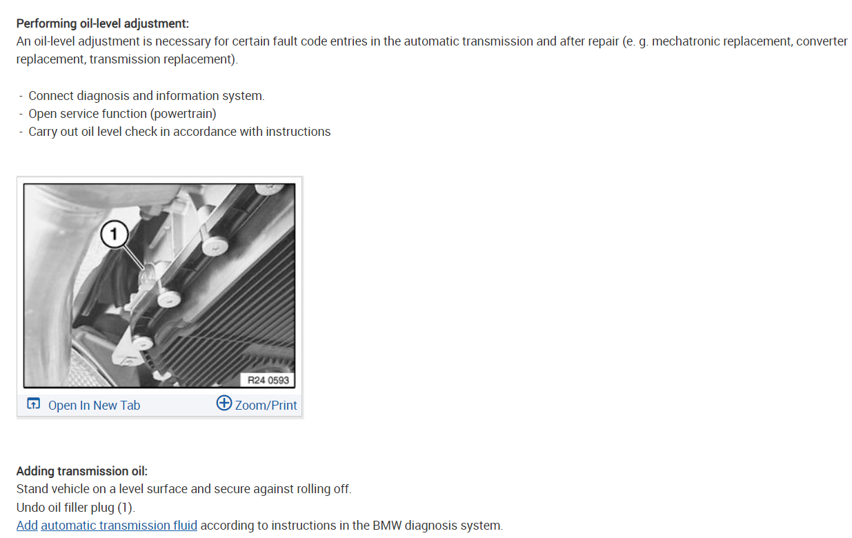

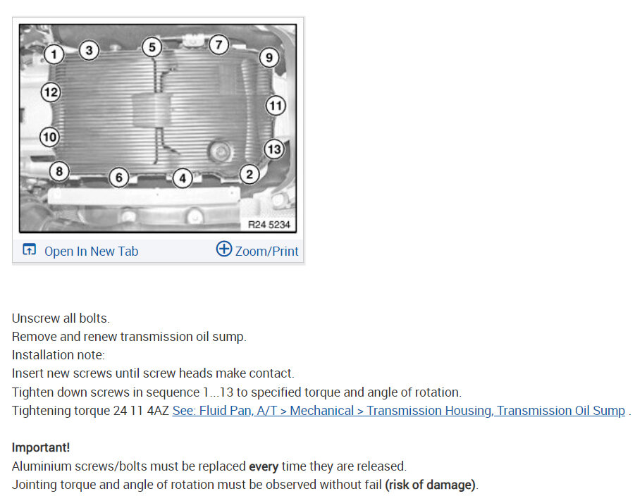

Sure, here are the specs and how to add or check the fluid level:
Total capacity, transmission and torque converter drained .................... approx. 8.5 liters
Shell M-L12108 (20.0 liters) .................... 83 22 2 152 426
ATF-3 (1.0 liter) .................... 83 22 2 305 397
Warning! Never mix any other oil with this transmission fluid when doing repairs or topping up. Use of any other oil will cause a non-warrantable transmission failure.
Refer to the transmission identification plate or the label attached to the transmission oil pan to determine transmission application.
There is a fluid plug on the driver's side of the transmission that is where you add fluid, and it is the level indicator as well. Check out the images (below). Let us know if you need anything else.

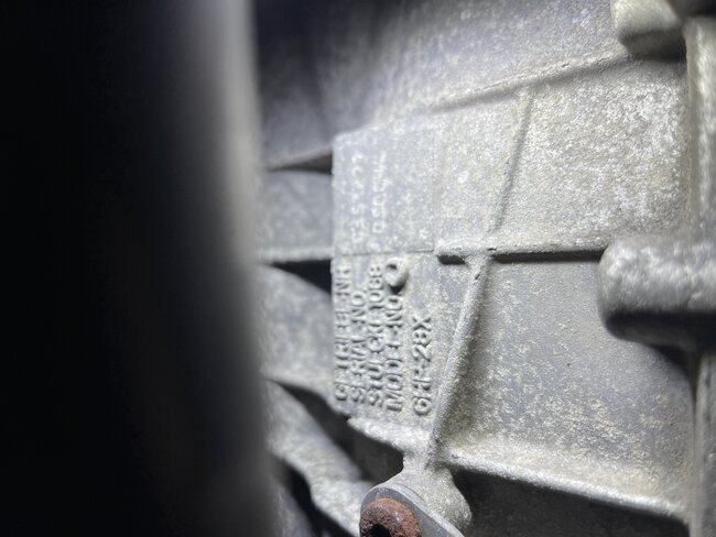

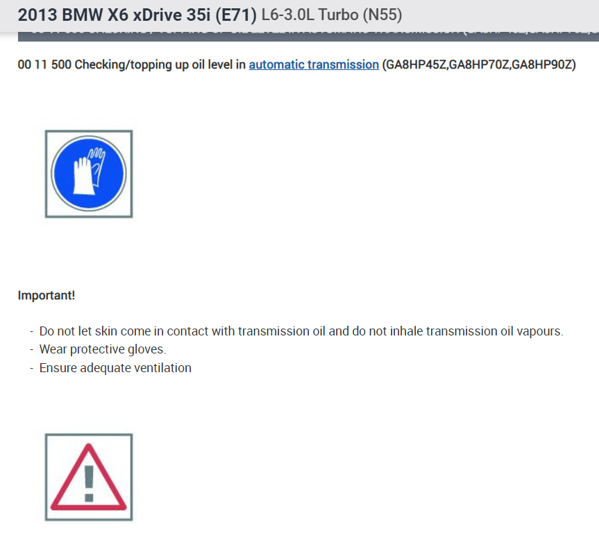

BHAMDOC1973
  • 2,007 POSTS
The instructions above shows that it is for a 35i which is the 6 cylinder, i have the v8.
Jan 4, 2024 at 3:07 AM
BHAMDOC1973
  • 2,007 POSTS
Here is the plate.
Jan 4, 2024 at 4:06 AM
  • 55,421 POSTS
it is the same fluid and procedure.
GA8HP45Z, GA8HP70Z
