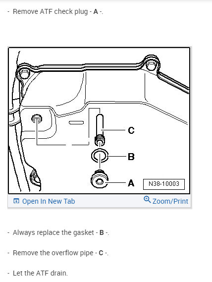

How do you do a drain and fill on these?
Mar 23, 2023 at 10:00 AM
  • 110,194 POSTS

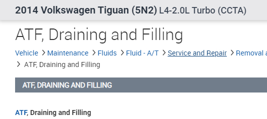

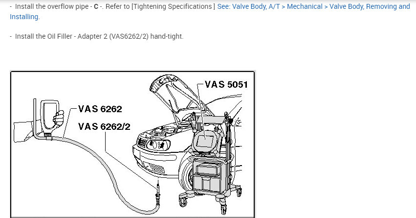

These are a little trickier than normal. You will need something that can pump the fluid upward into the transmission.
If you look below, I attached the directions. Let me know if you have questions that I can answer.
Also, note that there is a replaceable filter. You would need to remove the pan to access it, but I would recommend it gets replaced at the same time.

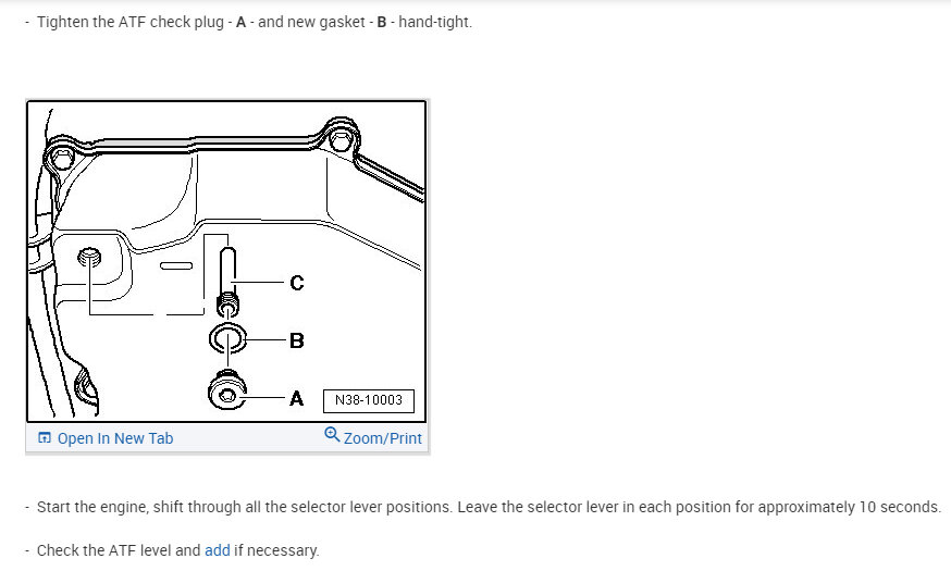

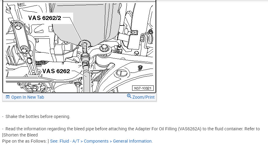

So, these do not need to be at a certain temperature? Filling from below is not an issue, i have several adapters. But do i start it then and disconnect the adapter and install the plug?
Mar 23, 2023 at 5:37 PM
BHAMDOC1973
  • 2,007 POSTS
Also how many quarts?
Mar 23, 2023 at 5:43 PM
  • 110,194 POSTS
If you are draining the fluid only, it should be approximately 4 quarts. Start by adding 2 quarts and top off from there.
When checking the fluid level, make sure the vehicle is on a flat surface. Next, start the engine and shift it through all gears.
Next, the trans temperature should be approximately 100 degrees F. I use an infrared thermometer to test the pan temperature. Once at 100 degrees, I continue adding until the fluid begins to drip from the fill tube you installed. This is done with the engine running.
